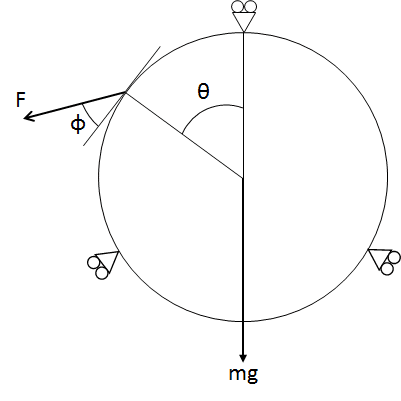

A rigid ring is fixed with three bearings evenly spaced around its circunference, which allow it to rotate but not to displace in the radial direction. An external force is applied in a fixed point P of the ring which moves with the ring. The bearings have friction.
These parameters from the problem are known: ring mass, radium and inertia momentum, external force (value F and angle phi) and friction coefficient. Obtain the expression for the angular acceleration as a function of these parameters and the angular position of the point P.
For the friction forces: F_fr = μN
I have tried projecting all the forces on the horizontal and vertical axis, and using Newtons Equations in the center of mass: ΣF = 0 and ΣM = Iα, but I end up with more unknown variables than equations.

First, projecting the force in the tangential and radial direction, with the angle phi:
FTAN = F cos Φ and FRAD = F sin Φ
Then, projecting this two again in the vertical and horizontal axis:
FX = -FTAN cos θ - FRAD sin θ
FY = -FTAN sin θ + FRAD cos θ
where the vertical axis Y is taken as the origin of the angle θ.
Considering that all normal reactions point towards the ring center, I apply Newtons laws in the center of mass. The normal reactions and friction forces are numbered 1,2,3 following counterclockwise order starting from the one in the top.
In X: N2 cos 30 - N3 cos 30 + FFRICT1 - FFRICT2 sin 30 - FFRICT3 sin 30 + FX= 0
In Y: -N1 + N2 sin30 + N3 sin 30 + FFRICT2 cos30 - FFRICT3 cos 30 -mg + FY = 0
Momentum around CM: R x (FTAN - FFRICT1 - FFRICT2 - FFRICT3) = Iα
And FFRICT = μ N for all 3 bearings.
So as I need to know the angular acceleration as α = f(m, I, μ, F, Φ, θ) I need to get first the expression of the normal forces (and with them the friction forces). And with this set of equations only I am not able to do it.
Apart from ##I = mR^2## I don't have much to contribute, I'm afraid.
Perhaps an extra assumption is required ? Because I see that increasing all three normal forces by the same amount of Newton does not change the problem description but it does change the outcome. (I.e. how tightly is the ring clamped in ?) A sensible assumption to reduce the number of degrees of freedom would then be to put ##F_{N,1} = 0## -- but then: why isn't it in the problem statement ?

@davidpascu, I forgot to ask... The description does not say whether the plane is horizontal or vertical. The diagram shows mg. is that in the original or did you add it?

The ring is in the vertical plane.
Actually this is not a fixed problem, but more one case of a more general model I need to do. The issue is this: I have a ring "pivoted" in several points with bearings so that it can rotate around it axis but not translate. The number of bearings is not fixed. The ring is in the vertical plane. The ring´s rotation is driven by a force such as the one in the example.
And I want to create a simple dynamics model that allows me to get the loads on the bearings. The problem I put in the heading is just the particular case of this model with 3 bearings. But I guessed it was easier to post one particular case than the global problem, and that if I managed to solve this one I could extend the solution to the other cases.

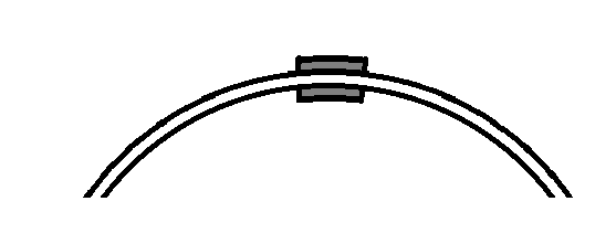

I guess the heart of the problem is how to model correctly the bearings. My first feeling was to put the reaction forces in the radial direction, because the bearings in essence work as sliders (prismatic joint, see picture below), but that leads to inconsistencies also, because if that, how can the reaction counteract the force in every moment to prevent the ring from moving if for example there is only one bearing, or there are two of them situated radially opposite?
