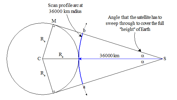

A geostationary satellite is located at 0'N 0'E (degrees), 36000 km above a spherical Earth with radius R(earth) = 6370 km. To scan the fieldof view, the satellite rotates around its own axis(oriented parallel to the Earth's rotation axis). It records one (constant latitude) scanline per rotation with the scan mirror steering the scanline in latitude with every rotation. A scan of the complete disc from North to South is allowed to take 25 min. With additional 5 min being required for returning the scan mirror back to its start position, one complete scan can be provided every 30 min.
When the horizontal resolution of a single scan pixel at the subsatellite point is 7.5 x 7.5 km, what is the rotational speed required to archieve this scan cycle ?

Start by making a sketch showing the angle that the vertical scan must cover in order to "see" the entire image of the Earth from pole to pole. Draw the scan profile at the distance that you know the resolution of the scan. How many scan lines are required to cover that profile?
Notice how the lines that you drew from the satellite to the poles cut through the circle of the Earth? That means there's some small portion that's lying outside of the scan. So those lines really should meet the Earth surface at a tangent, and not simply connect to the poles.
Sketch in the scan profile: That would consist of a circular arc centered at the satellite that touches the surface of the Earth at the sub-satellite position (where you also happen to know the resolution). What's the value of the angle ##\alpha##? What's the length of that arc bounded by the tangent lines?

They want to know how fast the satellite needs to rotate in order to completely map the observed surface area in 25 minutes. The mapping is done in horizontal strips, the width of which is dictated by the resolution. You should try to determine how many such strips will be required to complete the image.
Here's my sketch:
Find the value of ##\alpha##. Find the length of the arc ab. How many "slices" of width 7.5 km does it take to sum up to the length of the arc? That's how many rotations are required to scan the arc. You need to complete that many rotations in the specified time.

No, that's the angular size of one "slice", not the angular extent of the whole arc (from a to b on the diagram that I posted above).

Nope. Find the angle subtending the whole arc from a to b, then the arc length from that. Then find out how many "slices" fit the whole arc. Note that 30 minutes is not the scan time; it includes the 5 minutes required to re-position the apparatus to begin again.

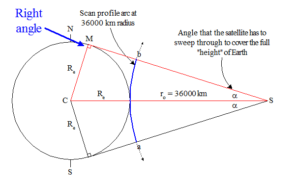

Look at the diagram. Are there any right-angled triangles that include α for which you know some side lengths?
If I am using α = tan-1(Re/(Re+RGeo) is that what you mean ?
That's the idea, but you've chosen the wrong trig function. Note where the right angle is. Which side is the hypotenuse?

No! "tan" is wrong. You don't have the opposite and adjacent sides of the triangle. Which sides do you have?

Look again at the diagram. I've highlighted the triangle in question in red. Of the three sides SC, SM, and CM you have values for both SC and CM. From the point of view of angle α which sides are they (Hypotenuse, Opposite, Adjacent)? What ratio can you form and what trig function does it represent?
If I am using Sin(α) = Re/(Re+RGeo) i got α to be ≈ 8.646°
Is this right ?
Is this right ?
Yes, that looks much better. Be sure to use radians when you calculate the arc length.
