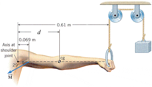

2.
The drawing shows an outstretched arm (0.61 m in length) that is parallel to the floor. The arm is pulling downward against the ring attached to the pulley system, in order to hold the 126 N weight stationary. To pull the arm downward, the latissimus dorsi muscle applies the force vector M in the drawing, at a point that is 0.069 m from the shoulder joint and oriented at an angle of 29°. The arm has a weight of 44 N and a center of gravity (cg) that is located d = 0.26 m from the shoulder joint. Find the magnitude of vector M .
Diagram of an outstretched arm parallel to the floor pulling down a ring on a pulley system that holds a hanging weight, with labels for 0.61 m, d, 0.069 m, cg, 29 degrees, the shoulder joint axis and muscle force vector M.
T = -Wa(La) - Wd(Ld) + M (Lm) = 0
I used the above equation to get M = [Na(La/Center of Gravity) + Nb(Lb)]/Lm
[44N(.26m) + 126N(.61m)]/[.69mcos29] = 146.316 N
That Answer isn't right and I'm really stuff on what I could be doing wrong.

  • Diagram of an outstretched arm parallel to the floor, pulling down on a ring attached to a pulley system holding a hanging weight. Labels show 0.61 m, d, 0.069 m, cg, a 29° angle, the shoulder joint axis, and vector M.

For #2, you should be considering the vertical component of M, so I'd reconsider the cos :) oh and this is porlly a typo but you have .69 written instead of .069

for #2 I got the answer 2639.61 N after using sine instead of cosine but i don't think that is correct either i got that yesterday as well and it wasn't correct. So would i use tan then for some reason?
= [ 44(.26) + 126(.61) ] / (.069sin29) = 2639.61376 N
GeoKenshin said:
Is there something wrong with my formulas for the second problem? I can't seem to get the right answer.
Your signs are off. The torque due to force M and the weight of the arm both act clockwise and thus must have the same sign.
