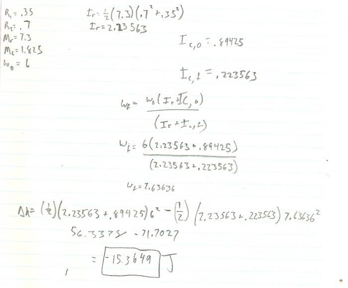

The picture shows an overhead view of a ring that can rotate about its center like a merry-go-round. Its outer radius R2 is 0.7 m, its inner radius R1 is R2/2, its mass M is 7.3 kg, and the mass of the crossbars at its center is negligible. It initially rotates at an angular speed of 6.0 rad/s with a cat of mass m = M/4 on its outer edge, at radius R2. By how much does the cat increase the kinetic energy of the cat-ring system if the cat crawls to the inner edge, at radius R1?
Overhead diagram of a blue ring with a white circular hole, cross bars at its center, labeled R1 for the inner radius and R2 for the outer radius, with a curved arrow showing rotation.
Handwritten physics working: R1 = .35, R2 = .7, Mr = 7.3, mc = 1.825, w0 = 6; moment of inertia of ring and cat terms, angular speed wf = 7.63636, change in kinetic energy ΔK = -15.3649 J.
I'm not sure I did this right. Is it possible for the answer to be negative.
THanks is advance.
You've calculated the initial KE minus the final KE, and it turned out negative. So the final KE must be greater than the initial KE. That's fine! The KE increased by the magnitude of your calculated value.

Thanks for the help. I was confused at first of why I got a negative number but you made it clear. Thanks once again.
