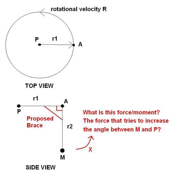

I'm not using numbers because I only want to understand the mathematical relationship. This is not a coursework question, but I imagine it stems from coursework level physics. I am trying to design a rotating arm for my own use and I want to calculate bracing requirements between the vertical and horizontal arm.
A mass M is at the base of a vertical post of length R2, which is connected to a horizontal arm of length R1 by a 90 degree angle. The arm of length R1 rotates at some rpm around pivot point P. I want to understand the mathematical method to find the force (a moment at the mass perhaps?) that tries pulls the arm R2 away from R1(ie making the angle larger than 90 degrees).
F = Ma (Newton's law)
T = radius * mass * gravity = (mass * distance^2) * (change in rotational angle/change in time)
T=2*pi*r/v=2*pi/w
I think I'm trying to find the vertically oriented torque at point M caused by the rotation of M and A around point P. I'm a little lost to be honest! I appreciate anyone hinting me in the right direction, I did physics quite a while ago and I am horribly rusty.

You need to find the centrifugal acceleration, the multiply it by the arm of the force.
This is the resulting torque that the point A will experience
(mass_{M})\ \omega ^2\ r_1 \ r_2

Without a drawing it's not easy to follow you.
In you drawing you asked for the force that tries to push M outside.
To counteract this force, you drew a brace.
Do you need to calculate the tension in the brace ? Eg. if the brace was a string ?

\omega={V/r_1}
without the square
F = (mass_{M})\ \omega^2\ r_1
is the centrifugal force
the torque is
\tau = F b
b = r_2
\tau = (mass_{M})\ \omega^2\ r_1 \ r_2
