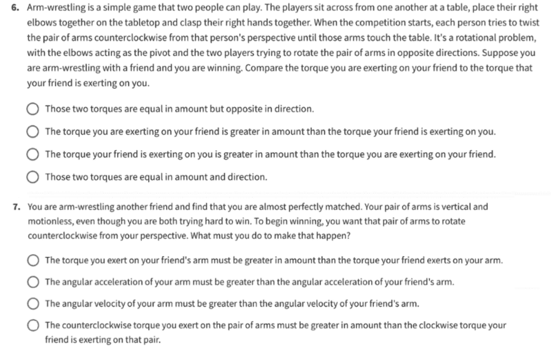

Please see below
Torque = F x r
For number 6 I answer (a) and for number 7 I answer (d) but I can say I just take a guess.
In question 6, I tried to think about Newton 3rd law. The force exerted by each arm on the other is equal so assuming the distance from the point where the force acts to the pivot is also the same, the torque is the same.
But in question 7, my reasoning for question 6 seems absurd. To win, I need to exert bigger torque so the arms can rotate in the direction I want to but it seems to contradict the reasoning in question number 6 so I am confused.
Thanks

Question 6 is asking about the interface where the arms meet. About the torque being applied across that interface.
We see that because the question asks about the "torque you apply on your friend" and the "torque your friend applies on you". The interface between your friend and you is at your hands.
Newton's third law for torques applies here. The two torques across that interface must be equal and opposite.
Question 7 asks about the torque that you exert on the arm pair and the torque that your friend exerts on the arm pair. This time we are considering two separate interfaces to a common object. One interface at your elbow and the other at your friend's elbow. Newton's third does not apply to these two forces -- they are not between the same object pair. This is a job for Newton's second law for torques instead: ##\sum \tau = I \alpha##. You know what you need ##\alpha## to be. So what does that imply about ##\sum \tau##?
I do not understand why @haruspex objects to choice (d) for question 7. It seems manifestly correct. He is usually spot on, however, so perhaps I am missing something.
It's because I missed the "pair of arms" change in wording. Thanks for picking that up.
However, it still isn't quite satisfactory. The excess torque only needs to be transitory; thereafter it suffices to match the torques.
