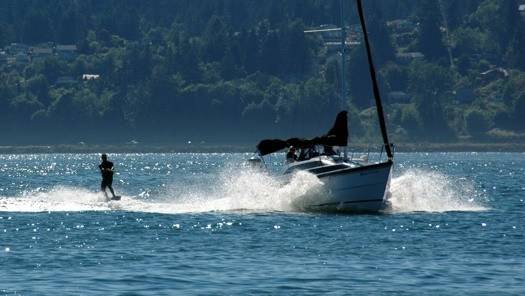

My sailboat is 29 feet long at the waterline, weighs 25000 pounds, and has a 30 hp engine.
Huh. My sailboat is 4/5ths as long, and 1/10th as heavy (yes, one-tenth), yet has 2/3rds more power.
(And a semi-planing hull)
:smile:
(That sounded like bragging. It wasn't mean to be. I was merely astonished at the range of configurations of boats.)
anorlunda said:
The fastest I have ever traveled under sail with zero current is 9 knots (way above hull speed, and in very strong wind conditions).
You were surfing down a wave I presume. (Well, I guess you'd pretty much have to be. Since you were well beyond hull speed, you were riding down your own bow wave)
I don't count any of my record sail speeds that are not sustained for at least 15 seconds. 6.7 is my top sustained.
(14.0 is my top, under power)

Yes the variations are huge. That is why displacement is a better measure of size than length. Mine, a Westsail 32, is famous as perhaps the toughest cruising boat ever built. The W32 Satori, survived The Perfect Storm without damage.
Your specs sound like a MacGregor 26; the opposite design extreme than the Westsail.
Hull speed is where you start climbing your own bow wave. The speed where you reach the top of that wave is much higher. So you can exceed hull speed without surfing or planing. When I did 9 knots it was sustained. I know that I could not have been at the top of my bow wave because I still had pitch stability. I averaged 7.5 over 24 hours that day, but my hull speed is 7.2 (By the way I had a feathering prop, so no prop drag of the kind discussed in this thread.)
I guess you can tell I like talking about boats. :smile:

YUCK! I would hope that real sailors would not consider this a true sailboat...I think it has a 60 Hp motor hanging off its stern. It is probably a terrible sailing boat. The weight of the engine alone would probably mess up its performance.
Note added: The propeller must be changed from that used at 5 kts since its pitch will be inappropriate for significantly higher speed. You must Increase the pitch.
Ah. The ol' No True Scotsman fallacy.
Yup. Well aware of the jealosy that motorsailers engender.
A sailor is someone who sails a boat (unless you're in the Navy or a Church St. bar on Toronto). And there are as many types of sailor as there are sailboats.
Sailboats come in a vast array of configurations to meet every sailor's preferences.
By definition, those who buy a given sailboat, do so because its merits beat those of every other sailboat.

gleem said:
By the way I am sorry if that was your boat. But that isn't even a proper motor sailer. IMHO.
It is my boat. I frequently bask in the glow of jealous sailors, who seem to think their idea of sailing is the only one there is. :wink:
Tell you what? Let's go out together one day, and have some fun:
  1. We'll sail in ridiculously high winds that knock us over to 45 degrees even when reefed. I'll have helm because my twin keels will still be in the water. What's your max heel before you lose helm?
  2. We'll wait until a squall is right on top of us before deciding it's time to head for shelter. I'm there in five minutes. You?
  3. Then, when we get bored of this lake by lunch, we'll haul our boats out, and trailer them (behind our 6-cylinder sedan) to another lake for the afternoon.
  4. We'll head up a nice cozy river, under a few bridges. I need 11 feet of overhead clearance. You?
  5. We'll go right up to the head of the river. My draft is 12 inches. Yours?
  6. At sunset, we'll pull right up and beach on the shore of a sandy lagoon and play in the surf.
  7. When the wind dies to zero, I'll tow you back to harbour in a half hour.
:biggrin:
