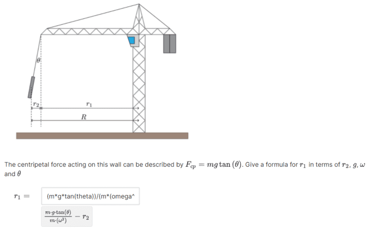

Please can my work be sanity checked? I think I'm on the right lines
See below
So I know
Fcp=-m*w^2*r
So from the equation -m*w^2*r=m*g*tan(theta)
r = r1+r2
so to rewrite
-m*(w^2)*(r1+r2)=m*g*tan(theta)
So
r1+r2=(m*g*tan(theta))/-m*(w^2)
r1=((m*g*tan(theta))/-m*(w^2)) - r2
Am I doing this nearly correct?

Yes, but one of your variables is not in the list of those allowed in the answer. Can you see a way to get rid of it?

Shouldn't ##r_2## be directly proportional to ##\omega^2##?

No the crane rotates around its base column, the radius of rotation is ##R=r_1+r_2## not just ##r_2##.
I can indeed! m's are overrated! Thank you for the confirmation
