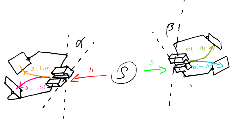

For this purpose, I suggest to imagine ion traps positionned at the output paths of the spin measurment devices. We would use 1/2 spin ions, and they would be trapped into a given box if they get out of the measurment device from one way, and into another box if they get out the other way. The boxes would isolate completely the ions from their environment, preventing them to decohere.
This way, position would be trivially entangled with spin and all the math stuff would be essentially the same.
By the way, when you measure spin with a Stern-Gerlach device, you don't measure the spin of the particule, you measure its position at the output of the device !

Hmm, that question seems really interesting to me:
What is the full (position and time dependent) wave-function of that singlet state, where the particles fly apart?

I'm sure about the full form of the wavefunction which is connected to that singlet spin state.
So far it has been useful textbook quotes and references only, but no self-made thinking. Maybe someone can help me figure out the full wavefunction. Something like a plane wave position part and a time-dependent part which is connected to some energy? I mean really a full solution at least for the initial state
[tex]\Psi=?[/tex]
