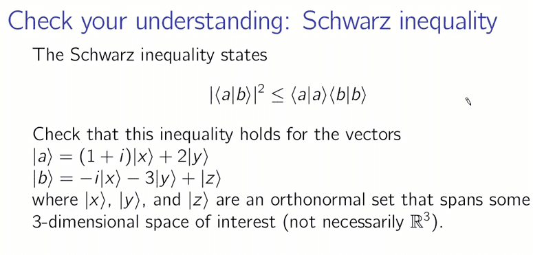

Slide titled Check your understanding: Schwarz inequality, stating |<a|b>|^2 <= <a|a><b|b> and asking to check it for |a> = (1+i)|x> + 2|y> and |b> = -i|x> - 3|y> + |z>, where |x>, |y>, |z> are orthonormal.
Hello,
I just want to make sure I am doing this right
$$<a|b> = a_{x}^{*}b_{x} + a_{y}^{*}b_{y} + a_{z}^{*}b_{z}$$
$$= [(1-i)|x>][-i|x>] + (2 |y>)(-3 |y>) + (0|z>)(|z>)$$
$$=(-i + i^{2})|x> - 6 |y> + 0|z>$$
$$=(-1-i)|x> - 6 |y> $$
Then to find ##\mid<a|b> \mid^{2}##, I need to take the complex conjugate since this is a complex vector
$$\mid<a|b> \mid^{2} = [(-1-i)|x> - 6|y> + 0|z>][(-1+i)|x> - 6|y> + 0|z>]$$
$$= 2|x> + 36 |y> + 0|z>$$
Now I want to make sure that this is even right before I spend time evaluating the other inner products to determine if Schwarz inequality is true.

The inner product is just a number not a vector. Try that again. In your formula ##a_x## is just the coefficient of ##(1+i)|x>##, i.e. ##(1+i)##.

ok, so then
$$<a|b> = 1 - i^{2} - 6 = -4$$
$$<a|a> = 1 + 1 + 4 = 6$$
$$<b|b> = 1 + 9 + 1 = 11$$
So clearly ##16 \le 6(11)##

Better slow down a bit. I don't think <a|b> comes out to -4. Want to show the steps that lead to that?
Sure,
$$(1-i)(-i) + 2(-3) + 0(1)$$
$$=-i+i^{2} - 6$$
$$=-i-7$$
So then the absolute value squared is ##(-i - 7)(i - 7) = -i^{2} + 49 = 50##
So ##50 \le 66##

That's better.
