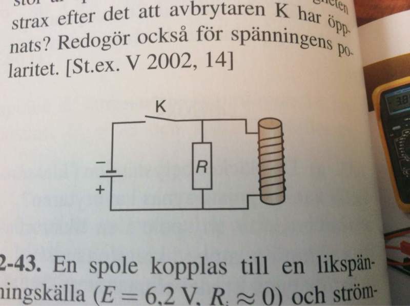

The wire in an electromagnet has the resistance 125 ohms and a parallel resistor has the resistance 4 kiloohms. The magnet is kept magnetized by a DC voltage 40V. What is the voltage over the electromagnet soon after switch K is opened? Also comment on the polarity of the voltage.
emf=-L(delta I/delta t)
V=IR
I have no idea because I'm not able to extract enough data from that text. The polarity should be the same according to Lenz's law. Answer is 2,3 kV.
Please don't use calculus btw, appreciate any help :)

After K has been closed for an adequate length of time, the circuit conditions reach steady conditions. What is this steady DC current through the inductor?
Self-inductance electromagnet, circuit
KVL: 40V-12.5I=0 I=0.32 A. I got that far. But now I realized what to do. :) Very soon after K is opened, I is still 0.32 A through the inductor, which now forms a closed circuit with the resistor. The voltage drop over the resistor is V=IR=1.3 kV, which equals the induced emf (according to KVL). :)

So when the switch is opened, you shouldn't apply KVL so that emf-125i-4000i=0? Then it would work like a battery with internal resistance. Or is that voltage drop not taken into account here?

The induced current should try to counter-act the decrease, so the induced current has the same direction. The emf would then have "the same" direction as the initial emf from the battery. Does the upper part of the inductor have positive potential then? Then the current goes through the resistor from positive to negative potential.
But through the coil it's the other way around which I don't really understand, is that analogous to batteries in any way? Do positive charges (in conventional current terms) go from negative to positive inside the battery?

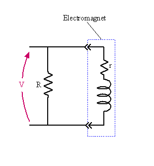

The voltage drop due to the internal resistance of the coil needs to be accounted for, sure. When you consider the voltage across the electromagnet it includes the internal resistance since it is inseparable from the electromagnet.
Drawn as "lumped components" the electromagnet consists of an inductor and resistor (at least in this approximation of a "real" electromagnet). The voltage V in the diagram is measured across the whole electromagnet, and the resistor R happens to be in parallel with the whole electromagnet.

gneill said:
Actually, using the 4kΩ value is correct. The resistance associated with the electromagnet itself is distributed throughout the wire comprising the wiring. You cannot separate this resistance from the electromagnet in any way, so if you were to measure the voltage across the electromagnet (say with a voltmeter), then you would necessarily have to include this resistance between the meter's probes.
Fortunately the 4k resistor is in parallel with the electromagnet and must share this net voltage.
I see, the wording was a bit ambiguous. For finding the induced voltage, it's the product of current x resistance, and OP's working is correct. Had the wording "resistor" been "resistance" it wouldn't have misled you (and led on to the confusion that then had to be sorted out).

The formula gives a positive value for the emf which makes sense. But does the upper part of the coil have higher potential?
Thanks for helping to clear this up! :) In the original post it says the answer is 2.3 kV but it should be 1.3 kV.

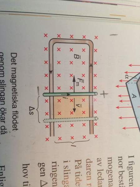

The upper end of the resistor is positive since current flows downward. Then it would make more sense to me that the upper end of the inductor is positive because the emf increases the potential. Can I compare it to the motional emf of a moving rod? In the picture, current flows counter-clockwise and the upper end of the rod is positive.

I'm just lost at this point. How can current go downward through the inductor when the circuit is in steady conditions, does conventional current not go from positive to negative? The current then goes upwards through the resistor as well, and when the switch opens the current's direction through the conductor is the same but the current through the resistor is now downwards, it's then in series with the inductor. That's how I understand it, maybe I should ask a teacher to explain face-to-face/in Swedish haha.
Sorry, I failed to notice the battery polarity, so you are correct. After the battery is disconected, the top of the resistor becomes positive, likewise the top of the inductor. You do have it correct.
