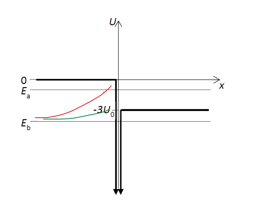

I'm not confident with the precise language I should be using. But descriptively, what would the sketch of the wave function look like in the case that there is a step. Does the curve on the left (x<0) still go upto ##U=0##?
which is correct for x<0?
Descriptively, the unnormalized wavefunctions are
##\psi_L(x)=e^{k_Lx}## and ##\psi_R(x)=e^{-k_Rx}##. Pick different numerical values for ##k_L## and ##k_R## and plot the first one for ##x<0## and the second one for ##x>0##. They are both equal to unity at the origin and vanish very far from the origin. The one with the large ##k## drops to zero faster. What else is there in a decaying exponential?

I'm going to take that to mean red.
Whatever "red" means, take it at face value. Like most people I need to sleep, especially when it's way past my usual bedtime.
The y-axis has units of energy, nothing to do with the wave function. You can scale it as you wish.

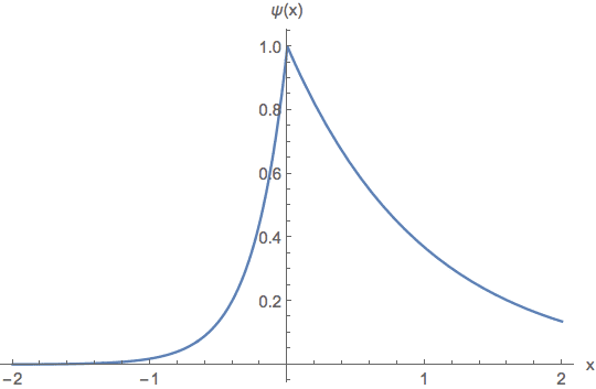

Neither. At ##x=0## the unnormalized decaying exponentials are continuous equal to 1. The ##k## value on the left is greater than the one on the right so it should decay faster as you move farther from the origin. See plot below where ##k_{left}=4k_{right}##.
