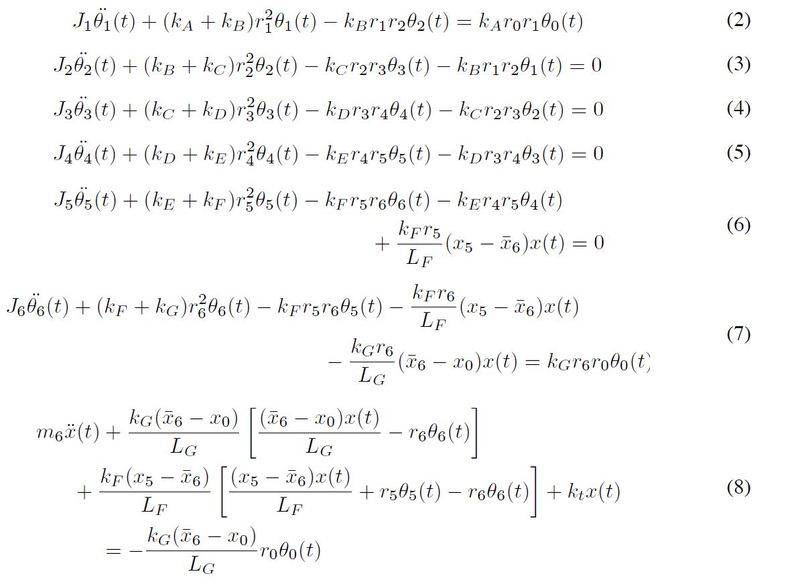

The second part is to derive the equations for motion, which are given so we can use them to check out answers.
Listed above in pictures.
