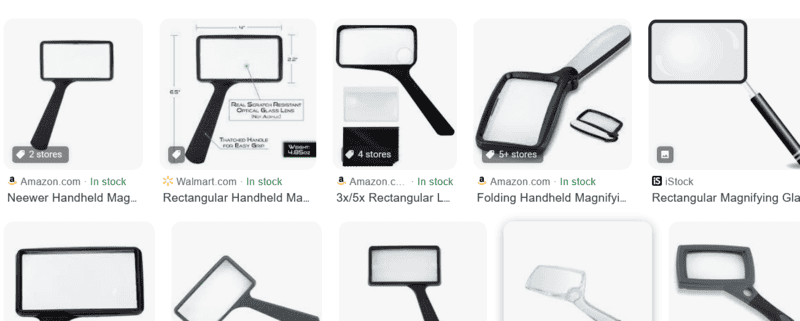

In a magnifying glass, the lenses are always circular. I don't understand why because no matter what shape the lense is, it doesn't deny its physical properties and refraction would still occur, so why are they so consistent on making circular lenses.
I predicted that circular lenses may be cost-efficient and easy to produce but if that's the case there must be a non circular magnifying glass out there but I haven't found one on the net so I deduced that my hypothesis was probably wrong and now I need an answer.
No, they are not. Not even close.
