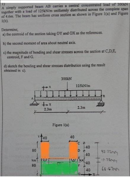

for this question , I'm having problem with the shear stress at point E and shear stress at centorid.
normally , the shear stress at the centoid will be maximum .
But , in my working , I found that the shear stress at the centroid is smaller than the shear stress at E. What's wrong with the working ?
i get y coordinates of centorid = 66.7mm
For Ixx , i get (5.00x10^-5)(m^4) , For V(shear force ) , I use (437.5x10^3)N
For shear stress at centroid , i use formula of $$\tau = V(Q) / It $$
so at centroid , Q = (66.67x10^-3)(160x10^-3)(66.67x10^-3 / 2 ) = 3.56x10^-4
so $$\tau $$= (437.5x10^3)(3.56x10^-4) / (5.00x10^-5)(160x10^-3) = 1.9x 10^7 Pa
at E , Q = Ay = (40x10^-3)(80x10^-3)(53.33x10^-3)**(2)** = 3.41x10^-4
so , $$\tau $$= (437.5x10^3)(3.41x10^-4) / (5.00x10^-5)(80x10^-3) = 3.6x 10^7 Pa
For Q at E i have labelled it with the orange part ,
for Q at centroid , i have labelled it with the green part ...

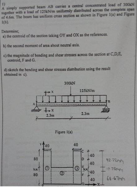

  • Cross-section of a beam shaped like a hollow channel with labelled dimensions 40, 80 and 40 mm, neutral axis NA, and handwritten values 93.33mm, 17.33mm and 66.67mm marked on the right.
Aything wrong with the question given ?
I'm getting the shear stress at centroid lower than the other point ( point E ) , is it possible ?
Or the question gt error
Yes it is possible because the thickness at the centroid is large. At point E there is a sharp decrease in shear stress due to the sharp increase in thickness at the webs interface.
