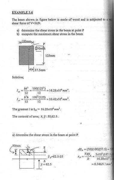

i know that to calculate the shear stress, formula is τ= (V)(Q)/ (I)(t)
So, why the author choose to use Ixx, but not Iyy for shear stress at P?
IMO, we should done the question in 2 ways, which are by using Ixx and Iyy respectively...Am i right?

The last part of the first line of the attachment is unclear. Does it say "... vertical shear force V = 3 kN" ?

Yes, it's vertical shear force of 3kN...
Because if a structural member can withstand the greater stress, it can also withstand lesser ones.
Thanks.
Since the shear force is applied in the vertical direction, the shear stress depends on Ixx rather than Iyy. From the diagram of the cross section, the neutral axis runs parallel with the x-axis.
Therefore, ##I_{xx} = \int y^2 \, dA##
which just happens to be greater than Iyy due to the orientation of the cross section.
The proper value of I is chosen not because it is greater, but because of how the shear is applied. If the shear were applied horizontally, then the shear stress at P would depend on Iyy instead of Ixx.
The shear stress at P is ##\tau = \frac {V ⋅ Q_x}{I_{xx} ⋅ t}##, where V is the shear force, Qx is the first moment of the area between P and the top of the cross section, calculated w.r.t. the neutral axis, Ixx is as discussed above, and the thickness of the section t is equal to the width of 100 mm.
