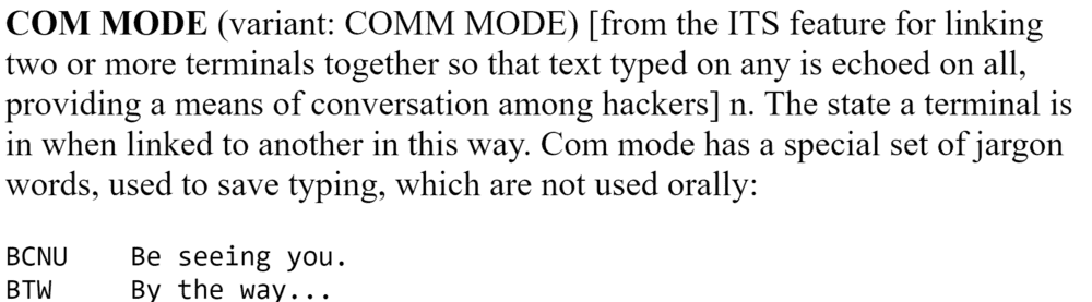

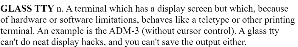

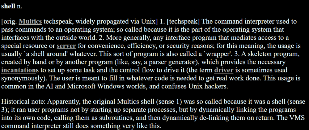

@Filip Larsen reminded me. The authoritative source for all such questions is The Hacker's Dictionary. Almost all the definitions originated in the MIT Multics project from the 60s.
Curiously, the dictionary has no definition for terminal but it does have this.
The Original Hacker's Dictionary also has no entry for terminal, but it has many for different kinds of terminals.
As you can see, a long list (truncated here) of acronyms still used today originate from use of terminals.
I am a great admirer of Multics. Every time I look into it, I am astounded at how many software issues, and software culture were strongly influenced by Multics. Ken Thompson and Dennis Richie were both Multics alumni when they created Unix.
