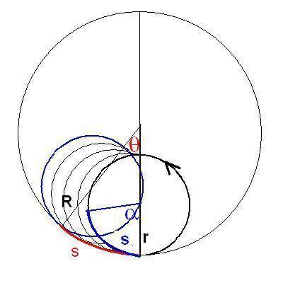

Think what rolling means. The point where the ball and cylinder touch each other covers equal lengths of arc both of the cylinder and ball. That gives a relation between alpha and theta.
Draw a big circle and cut out a small one, and try.
ehild

If a ball radius r rolls along the ground through an angle theta about its own axis, how far has the point of contact with the ground travelled? If now that ground is itself curved up with some radius R>r, what does that distance along the circumference tell you about the angle the point of contact has traveled around the ground's centre of curvature?
Imagine that you paint the inside of a tube with a roller painter. You turn the roller once, till the same part touches the wall again. How long is the painted strip with respect to the circumference of the roller? And how long is it when you roll it only half .. or 3/4?
ehild
It is equal to the circumference of roller.
Yes. so if you turn the roller by angle alpha = 2pi the strip is s=(2pi) r long.
If you turn only halfway alpha =1/2*(2pi) the strip is s=pi*r long. If you turn by alpha the strip is s=... long.
But the length of the strip is also s=Rθ, so how are alpha and theta related?
ehild
ehild
s=αr, therefore α=Rθ/r. Should I plug this in the equation I wrote for Potential energy?
Yes :)
