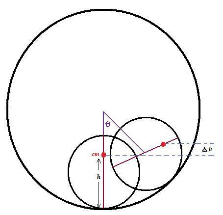

The angles are related as (R-r)θ =αr .Arent they ?
  • #32
What do you call alpha?
ehild
  • #33
α is the angle through which the object has rotated about its axis
θ is the angle through which the CM has rotated about the centre
  • #34
That is not right. The CM moves along a shorter arc as the common point between the cylinder and ball moves.
ehild
  • #35
ehild
Yes... you are right...the equation i have written says the same
distance moved by CM =(R-r)θ
distance moved by point on the hoop =αr
I am assuming the hoop rolls without slipping ...
  • #36
Yes, it is rolling without slipping.
ehild

Continuing from my previous equation:
[tex]U=2mgR(1-\cos \theta)+2mgr\cos \theta+mgr\cos((\frac{R}{r}-1)\theta)[/tex]
If I put θ=0, I get U=3mgr which verifies that the equation is correct.
What should be my next step?
  • #38
What happens if theta changes?
What is the characteristics of the potential function in case of SHM?
ehild
  • #39
Minimum at the mean position.
  • #40
How do you know if a function has minimum?
ehild
  • #41
ehild
By differentiating the given function.
  • #42
And?
It is U(theta). Differentiate.
ehild
  • #43
ehild said:
And?
And set the derivative equal to zero.
[tex]\frac{dU}{d\theta}=2mgR\sin(\theta)-2mgr\sin(\theta)-mgr\sin((\frac{R}{r}-1)\theta)(\frac{R}{r}-1)=0[/tex]
Simplifying, I end up with this:
[tex]2\sin(\theta)=\sin((\frac{R}{r}-1)\theta)[/tex]
How should I proceed from here?
  • #44
dU/dθ =0 at θ=0?
ehild
  • #45
ehild said:
dU/dθ =0 at θ=0?
ehild
Yes, its zero at θ=0.
  • #46
Is is maximum, minimum, saddle?
ehild
  • #47
ehild
I guess I have reached the answer. It should be minimum so that SHM takes place. For this, the second derivative is greater than zero at θ=0.
[tex]\frac{d^2U}{d\theta^2}=2mgR \cos(\theta)-2mgr \cos(\theta)-mgr \cos((\frac{R}{r}-1})\theta)(\frac{R}{r}-1})^2[/tex]
(Why the above code is not shown properly? :confused: )
At θ=0
[tex]\frac{d^2U}{d\theta^2}=2mgR-2mgr-mg\frac{(R-r)^2}{r}>0[/tex]
[tex]mg(R-r)\frac{(3r-R)}{r}>0[/tex]
Hence,
[tex]\frac{r}{R}>\frac{1}{3}[/tex]
The least r/R ratio is thus 1/3.
  • #48
[tex]\frac{d^2U}{d\theta^2}=2mgR \cos(\theta)-2mgr \cos(\theta)-mgr \cos((\frac{R}{r}-1)\theta)(\frac{R}{r}-1)^2[/tex]
At θ=0
Hence,
Well done!
ehild
  • #49
ehild said:
Well done!
ehild
Thanks ehild for the help! :smile:
Btw, is there any trick to do this question? This question is from a test paper and the solution says that for stable equilibrium, the condition is
[tex]\frac{1}{h}>\frac{1}{r}-\frac{1}{R}[/tex]
How did they arrived at this relation?
  • #50
What is h?
ehild

ehild said:
What is h?
ehild
The solution says that h is the height of centre of mass of ring particle system.
  • #52
The position is stable if the CM gets higher when the system is displaced. I do not see at the moment how that relation comes out.
ehild
  • #53
Use the same type of geometry you have already used to show that the change in height of the CM may be expressed as
##\Delta h = (R-r)(1-cos\theta) - (h-r)[1-cos(\frac{R-r}{r}\theta)]##
Use small angle approximation ##cos\beta = 1-\beta^2/2## to simplify the condition ##\Delta h >0## for small displacement of the hoop.
  • #54
Thanks TSny, I did reach the relation now but how can I find the least ration using the relation? :confused:
  • #55
What is h in terms of r?
ehild
  • #56
ehild
Oops, totally missed it, I was so much involved in deriving that equation of TSny that I forgot to use the value of h. :redface:
Thanks once again both of you. :smile:
