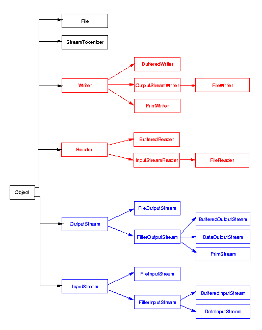

I am still confused about this whole I/O concept. My professor gave me an hierarchy of all the things related to I/O. But I am a little confused. Below is someing my teacher gave me.
First of all, I am confused about the RED part and the BLUE part. What is the diffrence? How do you know which one to use and how to use it?
Please expalin me the above so I can ask you my next question.
The blue parts are streams and the red parts are readers/writers. Streams are just raw flows of data, just bytes. Readers and Writers take a stream and interpret it as characters, and provide methods for reading and writing to the stream as characters, not bytes.

muna580 said:
Can you give me an example of Reader/Writers taking streams and interpreting as characaters? How come I don't use the streams use playing around with .txt files? How some when I use .txt file, I just go strait to FileReader? When do I use INputStreamReader?
Well, FileReader is just a convenience class. Basically,
FileReader f = new FileReader(file);
is roughly similar to saying
InputStreamReader f = new InputStreamReader(new FileInputStream(file));
but using the FileReader is shorter and a bit more convenient.

StringTokenizer is a legacy class that is retained for compatibility reasons although its use is discouraged in new code. It is recommended that anyone seeking this functionality use the split method of String or the java.util.regex package instead.
Well I/O is in principles very simple. You either want to read some data or write some data and the data is generally either in "binary" or as "text". I didn't understand that for some time, since hey a text file is a binary file at least I tough soo but technically that is not correct e.g. supose you want to write number 123 onto a file, now if you do it the binary way then the output would be 1111011 or in HEX that is 7B - the value of 123, but if you would write as text 123 to a text file then the output would be 001100010011001000110011, that is 00110001 represents the character '1' 00110010 is char '2' etc. The numbers may not be totally correct but the principles are. That is why you have Writers/Readers for text stuff and Input/Output Streams for binary data.

Readers and InputStream work similar only that you are reading and not writing text or binary sequence.
When using streams in Java it is VERY IMPORTANT that you CLOSE the stream after you have finished with whatever.
Now for your task, you could use directly the FileReader but if you look at the methods of the FileReader they aren't very friendly, just just have the read() method, soo if something doesn't look very friendly in Java it probably has a convenience class/wrapper whatever somewhere, how do you find a convenience class? JavaDocs, Web sites, Java Books, Forums, People, experience.

Backed on your's and Orthodontist, I understand the follwoing.
In I/O everything is broken up into 2 parts. Reading/Input or Writing/Output. So an example of Reading/Input would be like reading a file on a specific location such as "C:\ReadMe.txt". Then we have Writing/Output when we want to create a new file/append it and write on it. For example, We read the C:\ReadMe.txt file and then write the same content of it to C:\WriteOnMe.txt.
I hope I got that write so far. We let me try to explain my understand of In/Out Streams and Readers/Writer. In the picture I put below, the Readers/Writers are in red, and In/Out Streams are in blue. I am guessing that we would use the blue stuff when we want to read/write using binary , raw bytes. If we want to use characters to read/writer, we use the red stuff.
But according to my understand, the assignment that my teacher gave me contradicts. Teacher told me
(e) Make a backup copy of the file. To be as general as possible you should treat the file as a binary I/O task. Use the DataInputStream and DataOutputStream classes and the readByte and writeByte methods in your solution.
The "file" he is talking about is a ".txt". So we when we make the copy of the file, we are going to read everything in raw bytes and then writer everything raw bytes. So instead of useing characters, we are using binrary system. But why, if we are writing in streams/binary/bytes, am I able to read the backup copy of the file I made. Why do I see "words/charaters" and not 01010100101. I thought I used binrary instead of charaters. So if I wrote in binary, why do I see it?
a text file consist of a series of characters, characters can be read as binary stream - characters, that is why you can use binary stream to read a text file. But normally you would want to use writers/readers for text stuff they are more suited for that kind of job.
So I would use STREAM to copy a file for example like a music file. But I would use Reader/WRiter to copy text file?
