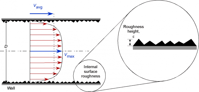

Diagram of turbulent pipe flow between two walls separated by distance D, with red arrows showing a velocity profile that is fastest at the centre (Vmax) and slower near the walls; Vavg is marked above. A magnified inset shows a rough wall surface with roughness height ε.

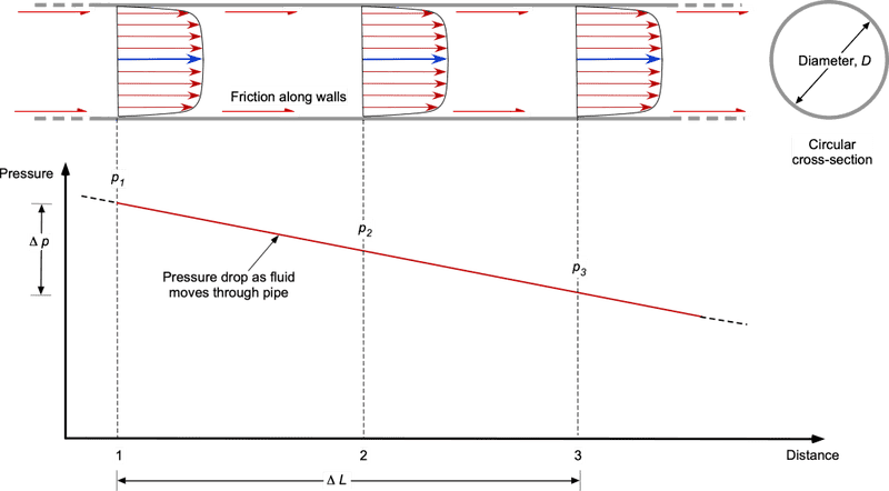

Diagram of fluid flow in a pipe: velocity profiles at three positions with friction along the walls, and a graph of pressure against distance falling linearly from p1 through p2 to p3 over length ΔL, with Δp marked on the pressure axis; circular cross-section of diameter D shown.

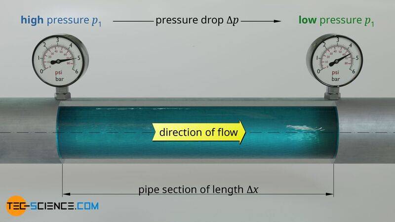

Diagram of a transparent pipe section with water flowing left to right, labelled direction of flow; pressure gauges at each end read high pressure p1 on the left and low pressure p1 on the right, with pressure drop Δp between them and pipe section of length Δx marked below.
