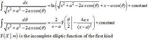

Integrals containing [itex]\frac{1}{\sqrt{x^2+a^2-2xa \cos{\theta}}}[/itex] occur frequently in physics but I still have problem solving them. Is there a general method for dealing with them?(Either w.r.t. x or [itex]\theta[/itex])
Thanks
These two integrals are commonly expressed thanks to logarithm and elliptic functions :

For respect to x:
Perform a trig substitution (not theta, a different variable) by first completing the square under the square root. A nice simplification will occur. Then proceed as you normally would after a trig substitution to get the first answer provided in the image provided in the post above mine.
This is how I did it :
[itex] \int \frac{dx}{\sqrt{x^2+a^2-2xa\cos\theta}}=\int \frac{dx}{\sqrt{(x-a\cos\theta)^2+a^2\sin^2\theta}}=\frac{1}{a\sin\theta}\int \frac{dx}{\sqrt{1+(\frac{x-a\cos\theta}{a\sin\theta})}}=\sinh^{-1} \frac{x-a\cos\theta}{a\sin\theta}[/itex]
Anyway...thanks both!
I'm positive it is a typo, but there is a missing exponent in the second last step. I haven't worked with hyperbolic functions since college so I missed that neat shortcut. Nice work.
