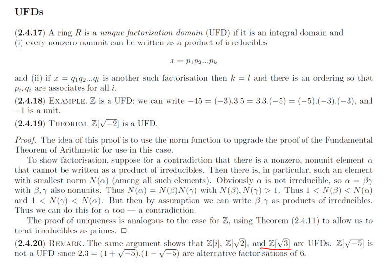

Show that ##\mathbb{Z}[\sqrt 3]## is a Unique factorisation domain
  • Thread starter Thread starter chwala
    Domain
15 replies · 5K views
chwala
2,844
434
see attached
Ring Theory
I am studying this now...i just want to check that my reasoning is fine,...

There is no element ##\sqrt{-3}## in ##\mathbb{Z}[\sqrt{3}]##.
A proof needs three parts: integral domain, representation of non-units, and uniqueness.

Just to share on my further analysis of this...; with your indulgence of course, i noted for UFD's, the non zero unit has to be written as a product of irreducibles. I noted that ##pε\mathbb{R}## is irreducible if;
1. ##p≠0##
2. ##p=a⋅b## where ##a## or ##b## is a unit.
Now going to the attached pdf on page ##1## we can say that,
##\mathbb{z}[\i]## is a UFD because;
we can have for example,
##\mathbb{z}[\i]=(1+i)(1-i)=2⋅1##
##\mathbb{z}[\i]=(10+i)(10-i)=101⋅1##
Now coming to,
##\mathbb{z}[\sqrt 2]=(1+\sqrt 2)⋅(1-\sqrt 2)=1-2=1⋅-1##
##\mathbb{z}[\sqrt 2]=(14+\sqrt 2)⋅(14-\sqrt 2)=196-2=194=97⋅2##
##\mathbb{z}[\sqrt 2]=(17+\sqrt 2)⋅(17-\sqrt 2)=287⋅1##
Now coming to,
##\mathbb{z}[\sqrt 3]=(11+[\sqrt 3)⋅(11-[\sqrt 3)=121-3=59⋅2##
The integer ##2## above can be written as a Norm in ##\mathbb{z}## i.e in the form;
##a^2+b^2## where ##n=(a+bi)(a-bi)## in essence,
##2=(1+i)(1-i)##
...before i continue further i think i need to wait for input...

You seem to be a bit confused. It would be better to concentrate on one specific ring at a time. Let us set ##R=\mathbb{Z}_3## for convenience and because it is the one you underlined in red.
I already showed you why it is an integral domain (a). Did you understand the proof?
How would you determine units?
Are prime elements and irreducible elements the same?
What are they?

Yes, i was able to follow your proof; i understand the integral domain part; the part i am interested on is the unit part where you have indicated that the product has to satisfy
##(a+b\sqrt3) ⋅ (c+d\sqrt3)=1## this is the part i want to understand. I seem to get it now, what they probably mean is that if ##a,b ε \mathbb{z}## then we have to check and see that ##a## and ##b## satisfy ##a±b\sqrt3=1## and not necessarily the way i was doing it (considered conjugates as products). For ##\mathbb{z}[\sqrt -5]##, we cannot determine the ##a## and ##b## values satisfying
##(a+b\sqrt-5) ⋅ (c+d\sqrt-5)=1##
Two remarks before I answer.
a) There is probably a more elegant answer than mine, e.g. by using the fact that ##\mathbb{Z}[\sqrt{3}]## is Euclidean, and therefore a principal ideal domain, and therefore a unique factorization domain.
b) Instead, I try a brute force method.
