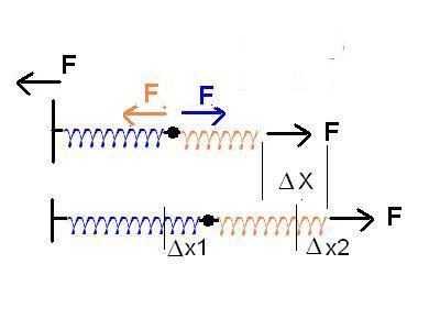

What is the spring constant of two springs connected in series? See picture.
You pull the orange spring with force F. At equilibrium, the net force for both springs is zero: the orange spring is pulled by F and at the other end it is pulled backwards by the blue spring also by F. The orange springs pulls the blue one with F, and the wall pulls the blue spring backwards with the same force. The tension is the same along a spring.
Both springs stretch, the blue one with Δx1, the red one with Δx2. ##Δx_1=\frac{F}{k_1}## ,##Δx_2=\frac{F}{k_2}##.
The whole spring stretches by ΔX=Δx1+ Δx2 by the force F. The resultant spring constant of the connected springs is [tex]K=\frac{F}{ΔX}=\frac{F}{Δx_1+Δx_2}=\frac{F}{\frac{F}{k_1}+\frac{F}{k_2}}=\frac{k_1k_2}{k_1+k_2}[/tex]

Well, yes, but you can break it down further (ehild's picture and post demonstrate this).
The mass is not in contact with the "springs," as in plural, but rather the mass is only in contact with spring k2. What does Newton's third law of motion say about the force on spring k2 and the force acting on the mass? (Note that nothing else is acting on the mass besides spring k2).
Similarly, what is the compressive force of spring k1 relative to that of spring k2? You can use Newton's third law to determine this at the connection point between the two springs.
That's what I meant about finding several things which are equal.
The individual, net displacement of each spring is not equal though. The springs will most certainly be compressed by different displacements, if the forces on the springs are equal and spring constants k1 and k2 are not equal.
But there is a constraint. If you add the individual, net displacement of spring k1 to the displacement of spring k2, how does that relate to the displacement of the mass?

For reference,
[tex]\frac{F}{\frac{F}{k_1} + \frac{F}{k_2}}[/tex]
As a first, interim step, find a common denominator of the [itex]\frac{F}{k_1} + \frac{F}{k_2}[/itex] terms in the overall denominator.
Myr73 said:
Thank you.. It all makes great sense,however there is one thing I am not sure of and its the switch from
F/ F/k1+F/k2 to k1 k2/k1+k2
Factor out F from the denominator, and simplify.
[tex]\frac{F}{\frac{F}{k_1} + \frac{F}{k_2}}=\frac{F}{F(\frac{1}{k_1}+\frac{1}{k_2})}=\frac{1}{\frac{1}{k_1}+\frac{1}{k_2}}[/tex]
Then do what colinsmark suggested, find the common denominator of 1/k1+1/k2...
