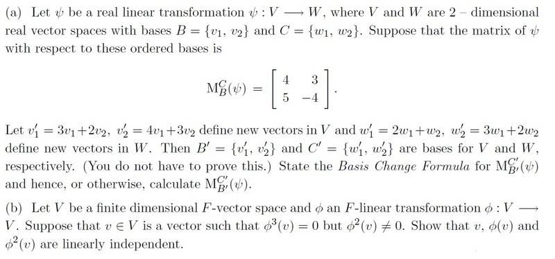

Please see attached question.
I can finish part (a)
For part b, how can I find ø(v) ?
Although I can find ø(v1) and ø(v2) but I think it is unrelated to ø(v)...

Part b isn't really related to the first part. If you assume ##v, \phi(v), \phi^2(v)## are linearly DEPENDENT what does that tell you about them? What's the definition of linear dependence? Try to use that to reach a contradiction to what you know about the vectors. If you can show one of them must be zero then you've shown they are linearly independent.

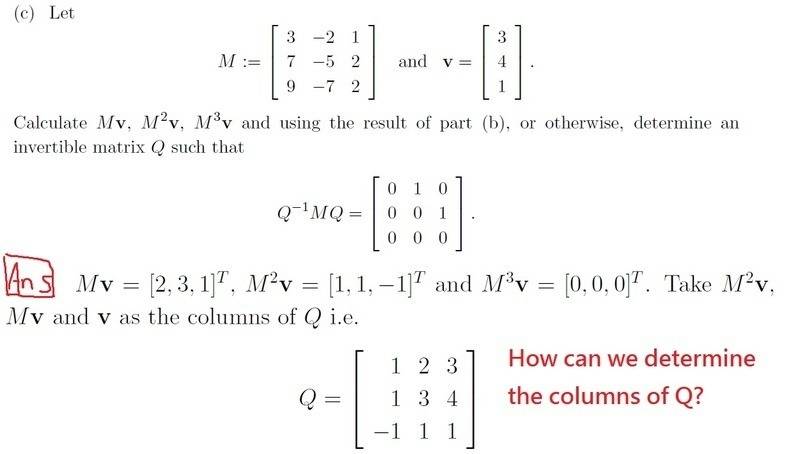

I have another question about part c.
Why column 1 is M^2*v? How can we know?
Please see attached. Many thanks.

That's not correct at all. You did get the definition of linear dependence right. So you have ##a_{1}v+a_{2}\phi (v)+a_{3}\phi^2 (v) = 0## (notice I wrote ##\phi^2 (v)## not ##\phi (v)^2## that's what you really want). It's worth trying to take it slowly and get this right. It's pretty basic. ##\phi^2 (v) \ne 0## doesn't imply anything about ##a_3##. I'll give you a hint. What happens if you apply ##\phi^2## to that equation? What does that tell you about ##a_1##?
It's much better to post new questions in new threads.

Nope, not correct. ##\phi^2( a_{1}v+a_{2}\phi (v)+a_{3}\phi ^{2}(v)) = a_1 \phi^2(v) +a_2 \phi^3(v) + a_3 \phi^4(v)##, what can you say about ##\phi^3(v)## and ##\phi^4(v)##??

It's not a contradiction yet. Now put ##a_1=0## into ##a_{1}v+a_{2}\phi (v)+a_{3}\phi ^{2}(v) = 0##. Any ideas what to do next?

So this is my complete proof of part (b), please have a look.
Assume v, ##\phi (v)## and ##\phi ^{2}(v)## are linearly dependent
i.e ##a_{1}v+a_{2}\phi (v)+a_{3}\phi^2 (v) = 0## for ##a_{1}, a_{2}, a_{3}## not all zero
## \phi^2( a_{1}v+a_{2}\phi (v)+a_{3}\phi ^{2}(v)) = 0 ##
=> ## a_1 \phi^2(v) +a_2 \phi^3(v) + a_3 \phi^4(v) = 0##
Since ##\phi^3(v)## = 0 => ##\phi^4(v)## = 0, we have ##a_{1}=0##
So the equation ##a_{1}v+a_{2}\phi (v)+a_{3}\phi ^{2}(v) = 0 ## gives ##a_{2}\phi (v)+a_{3}\phi ^{2}(v) = 0##
## \phi (a_{2}\phi (v)+a_{3}\phi ^{2}(v)) = 0 ##
=> ##a_{2}\phi ^2(v)+a_{3}\phi ^{3}(v) = 0##
and once again, since ##\phi^3(v)= 0## and ##\phi^2 \neq 0 ##
we have ##a_{2}=0 ##
so the equation ##a_{1}v+a_{2}\phi (v)+a_{3}\phi ^{2}(v) = 0 ## gives ##a_{3}\phi ^{2}(v) = 0##
since ##\phi^2 \neq 0 ## we have ##a_{3}=0 ##
This leads to contradiction, since we assume ##a_{1}, a_{2}, a_{3}## not all zero
so v, ##\phi (v)## and ##\phi ^{2}(v)## are linearly INDEPENDENT

That's perfect.

Almost. Correction in red. It isn't ##\phi^2## that isn't zero, it's ##\phi^2(v)## that isn't.
