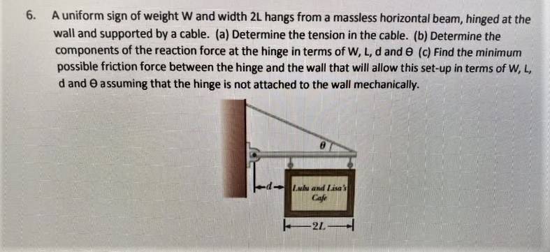

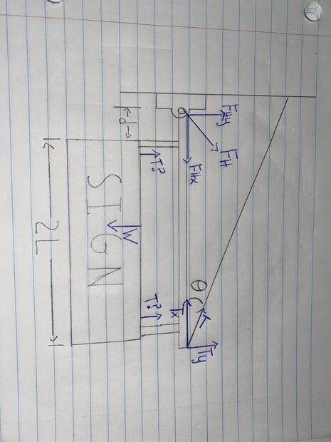

A uniform sign of weight W and width 2L hangs from a massless horizontal beam, hinged at the
wall and supported by a cable. (a) Determine the tension in the cable. (b) Determine the
components of the reaction force at the hinge in terms of W, L, d and ϴ (c) Find the minimum
possible friction force between the hinge and the wall that will allow this set-up in terms of W, L,
d and ϴ assuming that the hinge is not attached to the wall mechanically
Sum of Torques = 0
Sum of Forces = 0
Trig Equations
F=ma
Torque = Fdcos theta

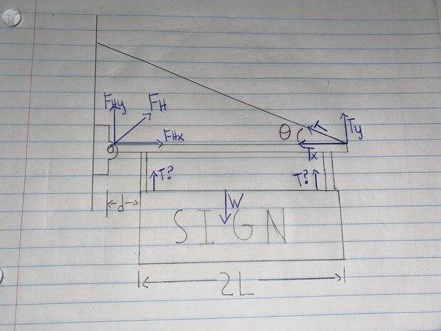

Attempted creating equations for zeros of torque and components of forces in x and y as seen in picture. Got lost with having only variables and the d & 2L for the length of the beam. Not sure how to do the question with two points of contact between the beam and the sign. Is the center center of mass changed because of that and/or what's the distance I use for that part?
  • Textbook problem diagram: a wall on the left with a hinge joining a horizontal beam, a cable from the wall to the beam's right end at angle θ, and a hanging sign labeled Lulu and Lisa's Cafe with width 2L and distance d from the wall.

Understandable, that was just my quickly written first attempt, here's a clearer process.
You have two versions of the torque the sign's weight exerts on the hinge, one with Wd, one with ##W\frac{d+2L}2##.
They're both wrong.
(When I said to number all equations, if you won't type them, I meant all.)
You have 3 things labelled T on the diagram. My red pencil would strike instantly.
Welcome, @hisiks !
Regarding your free body diagram (FBD):
You have assigned the variable T to three different forces.
You have assigned the variable F to the reaction forces at the pivot, which are normally identified as R.
Tx and Ty are understood as forces; therefore, it results confusing to see FTx and FTy in your equations.
You don't need to split the weight of the sign in two, for the moment induced by the weight, the application distance of that force is at the center point of the sign, regardless of how it hangs from the bar.
Please, try the FBD and associate equations again.
Also, it is a good habit to cross out any vector that you resolve into components, e.g. FH, to avoid double-counting or else just draw the two components.
Also your equation (4) is an identity and says T = T, nothing new.
