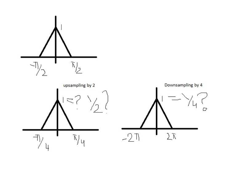

Does the upsampling and downsampling have any effect on the amplitude?
consider the following X(e^jw)
what will be the amplitude of the signals? do they remain 1 or are they to be divided/multiplied by L/M, L being upsampling factor and M being downsampling factor?
Please Help.
What is "up" & "down" sampling? Do you mean oversampling and undersampling? With relation to Nyquist rate?
up and down sampling means increasing or decreasing the sampling frequency!
ƩIncreasing or decreasing the sampling frequency for a given input signal x(t) does not change the amplitude opf the samples.
x(t) after sampling is Ʃx(nT)δ(t - nT) so x(nT) is the only thing that determines amplitude.
