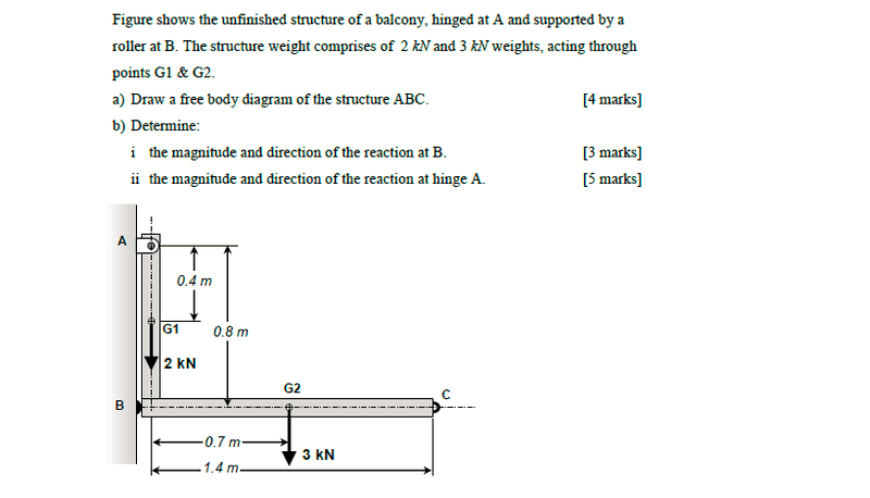

I cannot find i)
my method
0=2000+3000(0.4)-Rc
-3200N=-Rc(up)
0=3200-2000-3000+Ry
Rx=1800
How to find to magnitude, when roller only got y force, i can't use root(rx^2+ry^2)

I've no idea how you get these equations, or what Rc stands for. Please explain your analysis.
Since it's a roller against a vertical beam, I would think it can only provide an x force.
But where's the difficulty in finding the magnitude if there were only a y force? What would root(0^2+ry^2) give you?

They only provide 2 y force, so how i use that to find rx?
You haven't shown us, or at least described in words, your free body diagram. Tell us what you got. That's key to the rest of the problem.
My free body diagram got two reaction for at A, 1 reaction force at B at including the G2, G1 force and also one reaction force at C
From the diagram, it doesn't seem that there is any reaction force at C. Next, please write for us your force balance in the vertical direction, your force balance in the horizontal direction, and your moment balance around around hinge A.
3(0.7)+2(0)=Rb(0.8)=0
Rb=2625

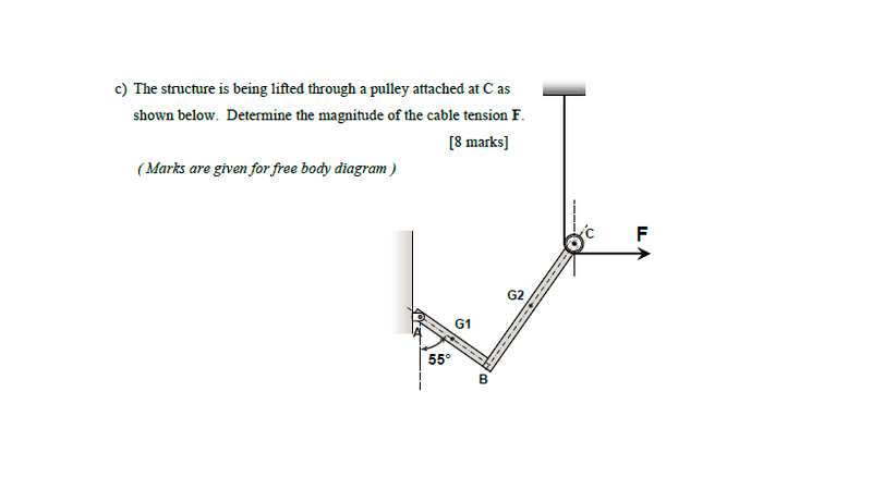

I now know how to RX RY at hinge A and answer b, but c quite difficult. i need some guidance
My guess is that I need to find the Rx Ry of the pulley and them derive the magintude of the F through Fr=root(x^2+y^2)
Rb=2625
You are missing the decimal point in your equation for Rb. To get Rx and Ry at A, you need to do horizontal and vertical force balances.
Part c starts out with a geometry problem. You need to find out how far to the right point C is relative to point A, and you need to find out how far point C is above point A. Can you do the geometry to find out those distances?

Can check my working
taking moment at A=2000cos35 (0.4) + 3000sin83.81(1.06) / 1.6(sin64.74) = (wrong answer)
can anyone help me check
AD= 1.6
AG2=1.06
AD= 1.6
AG2=1.06
I agree with your moment arm to G1, but, for the moment arm to G2, I get (0.8cos35+0.7sin35)=1.06
Also, you left out the moments about A resulting from the horizontal and vertical components of rope tension at C.

thanks
Chestermiller i have solve the question.
