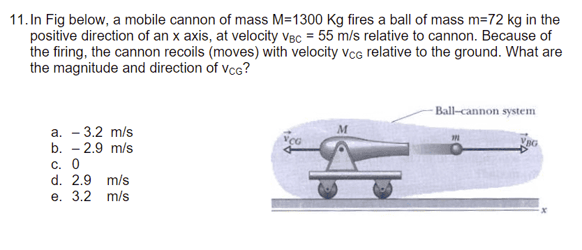

In Fig below, a mobile cannon of mass M=1300 Kg fires a ball of mass m=72 kg in the positive direction of an x axis, at velocity Vbc= 55 m/s relative to cannon. Because of the firing, the cannon recoils (moves) with velocity Vcg relative to the ground. What are the magnitude and direction of Vcg?
Pi=Pf
Since Pi = Pf,
0 = MbVbg + McVcg
I just need to express Vbg in terms of Vbc and Vcg (that is, I need to express the velocity of the ball relative to the ground in terms that I know/want to solve for):
by reference frames:
Vbc = Vbg + Vcg
so Vbg = Vbc -Vcg
Now I can sub in and solve
0 = MbVbg + McVcg
0 = Mb(Vbc -Vcg) + McVcg
0 = MbVbc - MbVcg +McVcg
MbVcg - McVcg = MbVbc
Vcg(Mb - Mc) = MbVbc
therefore,
Vcg = 72*55/(72-1300)
= -3.2 m/s
which would be a.
HOWEVER the teacher's answer key states that the answer is b, -2.9 m/s.
this answer is obtained if the denominator was " (- mb - mc) ".
Thus, did I just mess up somewhere with my signs? I can't find mistake, and any help deducing this would be appreciated, as I was pretty confident about my answer until seeing that it was wrong.
Yes. The signs are inconsistent between the two equations
0 = MbVbg + McVcg
Vbg = Vbc -Vcg
Give it some more thought.
TSny said:
Yes. The signs are inconsistent in the two equations
0 = MbVbg + McVcg
Vbg = Vbc -Vcg
Is the momentum equation supposed to be0 = MbVbg - McVcg
Because Vcg is pointed in the opposite direction to Vbg?
If that's true, you get
Vcg = MbVbc/(Mb+Mc)
= 72*55/(72+1300)
= 2.9
which is then negative through intuition (since its moving in the opposite direction?)
Though i suppose this works, I feel like there's a better / more accurate way to show the signs in my algebra.
Thoughts?
Assuming you are taking right as positive in all cases, your original momentum equation was correct.
In writing relative motion equations, the safest approach is always to write them in the form
Motion of A relative to B = Motion of A relative to common frame - Motion of B relative to common frame.
Ah so if its the other equation, I was wrong initially
so at first it would be:
Vbc = Vbg - Vcg
meaning
Vbg = Vbc + Vcg
Then the rest is the same:
0 = MbVbg + McVcg
0 = Mb(Vbc + Vcg) +McVcg
0 = MbVbc + MbVcg +McVcg
Vcg = -MbVbc/(Mb+Mc)
= -72*55/(72+1300)
= -2.9m/s
And THATS correct
So it was just a dumb mistake with the first reference frame equation
Thank you for your help!
