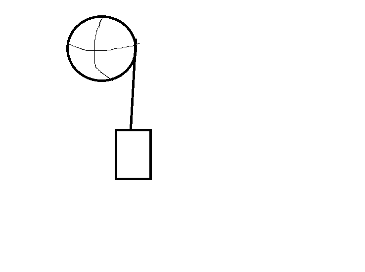

A ball (hollow sphere) of radius .11m and mass .444kg is mounted on a frictionless axle. A massless cord is wrapped around the ball supporting an object of mass .02kg. Find the angular acceleration of the wheel, linear acceleration of the object and tension in the cord.
[tex]\Sigma[/tex]F=Fg+T=m*a
-.2+T=.02a
[tex]\Sigma[/tex][tex]\tau[/tex]=F*r=I*[tex]\alpha[/tex]
-T*.11=(.0036*a)/.11
T = -.2975*a
-.2 + .2975*a = .02*a
-.2 = -.2775a
.72 = a
That's what I tried, but it's wrong.
Can anyone help?
-.2+T=.02a
0.2 -T = .02a
T*.11 = .0036a/.11
T = -.2975*a
T = .2975a
-.2 = -.2775a
.72 = a
Can anyone help?
You must watch your signage. The acceleration is downwards. Choose the downward and clockwise directions as positive, for compatability and simplicity.
