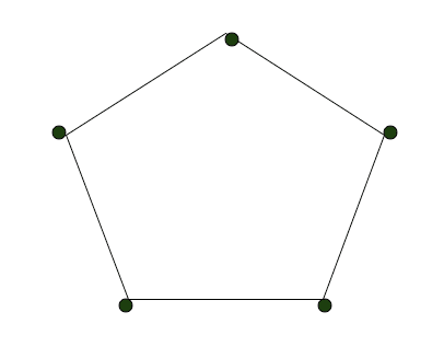

The answer is zero. But I am not sure what I am missing. I am using a Pentagon to do the analysis (I don't feel like drawing a 13-sided object).
It seems like I need to know a little more about the geometry of a Pentagon. How is the center of an odd-number-of-sides polygon defined?
I am assuming that in is not equidistant from ALL of the vertices? Otherwise i don't see how it could be zero.
Am I making this more difficult than it is? Am I just supposed to look up the formula(s) for the center of a 13-sided polygon?

Before the q was removed, the force at the center is zero due to symmetry. This means that the force due to the q is equal and opposite to the net force due to the rest of the charges.

But if it is 13-sided, how is it symmetrical? There would be 1 unpaired charge.
It's not about pairing, its the way they are arranged. Think about an equilateral triangle with 3 charges at the tips. The force at the center will be zero.

There are no pairs. There would be pairs if you had two charges directly across from each other, then you could call them a "pair" and their forces would cancel out. And that does indeed happen in a polygon with an even number of sides. But in a regular 13-sided polygon, the "thing" across from a charge is just the empty space between two charges. (i.e. a side of the polygon) So you can't talk about pairs of charges.
It turns out that when you add up the forces from the charges at the corners of a regular 13-sided polygon (or any regular polygon), at the center of the polygon, the forces cancel out. You can see this by figuring out what the forces actually are (as vectors) and by adding them up, but there's an easier way: by symmetry. Think about this: if there were a force on a charge at the center, which way would it point?

The vertices of a regular polygon can always be made to fit on the the circumference of a circle, so you can think of the center as the center of the circle.

Draw lines from the center to each of the vertices. The angles between adjacent lines will be the same.

If I want to locate the center of a pentagon, without using a circle, how would I find it?
Would I draw a line from each vertex to the midpoint of the opposite side? And their intersection would be the center?
Draw a perpendicular from the center of each of the sides. They will intersect at the center.

If it's a regular pentagon, yes, that is one way that would work. (If it's not a regular pentagon, there are multiple ways to define the "center" and they give different points, so it's kind of a meaningless question... but let's not worry about that ;-)
