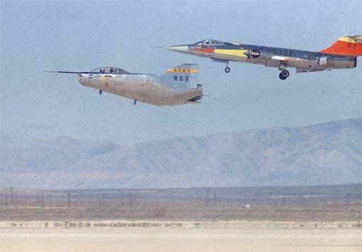

Not on all wings, the air foil on this lifting body has the longer path on the bottom:
With a positive angle of attack, I highly doubt that that is true. It isn't true of an inverted cambered airfoil, for example. The high angle of attack moves the stagnation point downward on the front of the airfoil, causing the air over the top to have a longer path.
[edit] Note, the profile is somewhat deceptive: it looks perfectly flat on top but in fact starting 2/3 of the way back, by the tail, the top surface angles down to meet the bottom surface. So the top surface is quite a bit more curved than it looks. The craft is also much wider at the back than at the front, so the bulbus front in profile is actually a lot less of the full airfoil than it looks to be. http://www.google.com/url?sa=t&source=web&cd=13&ved=0CBkQFjACOAo&url=http%3A%2F%2F65.165.5.234%2Fcenters%2Fdryden%2Fpdf%2F87738main_H-479.pdf&ei=FguYTNKzMcX_lgfH-_wo&usg=AFQjCNHAa2PHYMddzRzp3DivzQB8yzMB_g

The air foil on this lifting body has the longer path on the bottom:
At sufficient speed, such as seen in the photo, the visual angle of attack of the leading upper surface is zero. At higher speeds, the m2f2 glided a bit nose down. The pdf file mentions a negative angle of attack used at higher speeds, but doesn't mention how the "chord line" for the m2f2 was defined which would determine the described angle of attack.
The aft part of the m2f2 is tapered, and both the top and bottom surfaces angle towards each other, but they don't actually meet, the aft surface is vertical and a bit over 1 foot tall. This increases the drag, but being a re-entry vehicle, a high lift to drag ratio isn't one of the goals.
Although drag would be high, an airfoil could be a simple wedge with the narrow end at the front and the wide end at the rear. Given sufficient air speed, this wedge could fly with the top surface horizontal or pitched downwards a bit. This would be an example where the longer path was below a wing.
However this is going somewhat astray from the OP, which was asking about wings on aircraft, and the examples I mentioned are unusual air foils, and not the efficient air foils used on aircraft.
