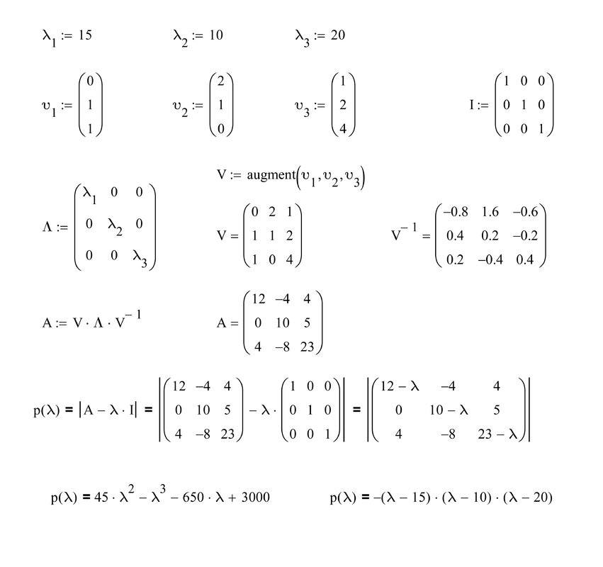

Why not just build it up backwards. Pick some eigenvalues and some eigenvectors and compute the transformation matrix? Like in the Wikipedia post above (post #8). Where A = QΛQ-1.
Likes jedishrfu
Here's one I made with (mostly) random guesses:

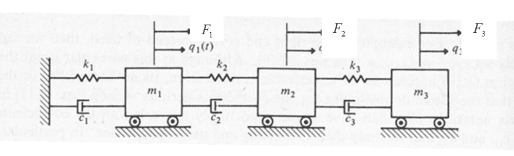

Thanks everyone, but I do not think it is possible.
Either roots repeat or the numbers do not have closed form.
And to be more informative, I was really trying to find the spring and mass relationships I could use so that I could obtain closed form numbers for the eigenvalues of this problem (where the damp and forcing values were zero).
But I do not think it is possible to get the eigenvalues in such a form without a numerical solution.

Exactly. I do not mind if the roots evaluate to terms like 1/sqrt(3) or something.
And I need it for a Generalized Eigenvalue (of the type you get with the three mass oscillator)
A x = Lamda B x
NOT: Ax = Lamda x
but I don¨'t think it is possible. So don't worry.
Ok, so you ARE using generalised eigenvalue problem in the technical sense of the word. However, the responses you got were referring to the standard eigenvalue problem. So the solution to the generalised eigenvalue problem is $$det(A - \lambda B) = 0$$. Finding solutions to that problem involves something called a matrix pencil (https://en.wikipedia.org/wiki/Matrix_pencil). In the most general case where A and B might not be invertible you won't find an expression for lambda, but it can be solved numerically using the QR algorithm.

Is B diagonal in your case, or am I missing something?
Let the spring connecting mass 1 \leq i \leq N to mass i + 1 have constant k_{i+1}. Then the equation of motion for mass i is <br /> \begin{align*}<br /> m_i \ddot x_i &amp;= k_{i+1} (x_{i+1} - x_i) - k_i (x_i - x_{i-1}) \\ <br /> &amp;= k_{i+1} x_{i+1} - (k_{i+1} + k_i)x_i + k_{i}x_{i-1}<br /> \end{align*} and hence <br /> \ddot x_i = \frac{k_{i+1}}{m_i} x_{i+1} - \frac{k_{i+1} + k_i}{m_i}x_i + \frac{k_{i}}{m_i}x_{i-1} with the understanding that k_{N+1}x_{N+1} = k_1x_0 = 0.
Now if you seek a solution of the form x_i = X_i \cos(\omega t - \phi) then your eigenvalue problem for \omega is <br /> -\omega^2 X_i = \frac{k_{i+1}}{m_i} X_{i+1} - \frac{k_{i+1} + k_i}{m_i}X_i + \frac{k_{i}}{m_i}X_{i-1} which is a standard eigenvalue problem.
Now in theory you could work out the coefficients of the polynomial satisfied by \omega^2 and set them equal to the coefficients of a polynomial having your desired roots. Since the coefficient of \omega^{2N} is 1 that yields N equations in the 2N unknowns m_i and k_i, which gives you some freedom in choosing them.
