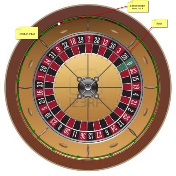

I am trying to understand game of roulette through kinematic equations of circular motion. Roulette is game where a ball spins in circular motion. Initially it is accelerated such that velocity of ball increases with time however after reaching its peak value it starts to decelerate until it finally leaves its circular track and falls in rotar. (ref: attached image)
Diagram of a roulette wheel with the ball shown on the outer track, marked with a red arrow and a green arrow indicating its direction, and a label pointing to the rotor.

There are several issue with this question...
Not sure I agree with that. The ball will start to decelerate the moment it leaves the hand. So if time starts at that moment there won't be any acceleration phase.
Mahowny said:
Angular velocity of ball at sixth revolution can be calculated as follows:
ω6=θ6/t6=9.7288 rad/s
That's not correct. That's an average for the velocity over the first six revolutions not the final velocity after six revolutions. The ball is decelerating so the velocity after six revolutions will be slower.

You need to take into account the ball deceleration isn't actually constant. This is because the wheel is often placed on a slightly angle table and the ball track, where the ball rolls is not completely flat. So it has a kind of wave effect. I can send you some information about it if you want just message me.
