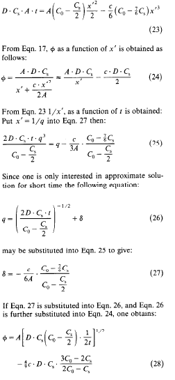

Hello,
may someone be so kind to explain how to arrive, step by step, from equation 23 to 28?
I simply cannot arrive at the result, no matter what, and I cannot explain how they got δ.
See the attached image.
Thank you very much.
Mario

All the steps appear to be explained by reference to a previous relation (not pictured) except for the last one ... where an approximation has been used.
i.e. eq23-24 requires eq17.
I would like to understand only the approximation.
Maybe I could have got the logic behind: "approximating a cubic polynomial with a quadratic"; but if I substitute eq26 in 25 I get a different result (e.g. delta^3 terms).
eq24 may be taken as it is, take phi as just
  • Equation: (A · D · Cs) / x′ − (c · D · Cs) / 2, with the first term's denominator x′ and the second term's denominator 2.

... so it is eqn 26 that is tricky?
The idea is to approximate for small time frames.
The form of the equation 25 is ##\alpha q^3 = q - \beta## ... which is a cubic equation.
Solve it for q, without making an approximation and compare.
They appear to have approximated it as ##(q-\delta)^2 = \alpha## and that delta is a parameter to be fitted.

1) I can't figure why delta is beta/3 (using your notation for the terms) and I have no clue on how to fit delta
2) Also if I use that expressions in eq26 and eq27 for q and delta, putting them into phi (eq24) do not give 28: only the first term is correct (the one with the square root) and there is also a cDCs/2 which is not multiplicated to any C0; is there another approximation?

It was my mistake in the substitution of q+delta inside eq24, I've found that using eq26 and eq27 do actually bring to eq28, so no problem between eq26 and 28.
Last thing I would like to know is how that fitted term came out... I knew that every approximation should be based on Taylor series (!) any clue?
Basically, the tricky thing is eq26.

I haven't still figured out how to arrive at the result...
I have
[itex]q=aq^3+b[/itex] [eq#1]
that can somehow (?) be approximated with [itex]q=a^{-0.5} + \delta[/itex] [eq#2]
with [itex]\delta=b/3[/itex]
Why is [itex]\delta=b/3[/itex]?
you have ##aq^3-q+b=0##
and you want an approximation, it says, for small times (remember that a is a function of time).
does that mean that aq^3 is small?
q=1/x' ... how does x' depend on time, in general?
The approximation they came up with is ##(q-\delta)^2 = a##
So they are saying that the cubic can behave like a quadratic for a short time.

Simon Bridge, I have managed to reach the solution, THANK YOU SO MUCH!
Premise: Having a look at eq 27 and using your notation we have that
δ is -b/2 not b/3 (sorry for the mistake :smile:)
So we have two equations, basically:
[itex]aq^3-q+b=0[/itex] and [itex]q=a^{-0.5}+\delta[/itex] with a small δ
Writing those two equations in a system, we have that the δ that satisfy both equations is a δ that satisfy this 3rd order equation:
[itex]a\delta^3+3a^{-0.5}\delta^2+2\delta+b=0[/itex]
ignoring third order and second order terms in δ we have simply
[itex]2\delta+b=0[/itex] so the result [itex]\delta=-b/2[/itex]
:smile: :smile:
There is a clearer way to reach the result :smile:eq.#1 is [itex]aq^3+b=q[/itex]
eq.#1 would be simpler if b=0, the zero-order approximation is
[itex]q_0=aq_0^3[/itex] so [itex]q_0=a^{-0.5}[/itex]
The next order (1st order) approximation is
[itex]q=q_0 + \delta[/itex]
It is assumed that [itex]\delta[/itex] is small in comparison to [itex]q_0[/itex] so that all the terms in [itex]\delta^2[/itex] and [itex]\delta^3[/itex] are discarded and
[itex]q^3=(q_0+\delta)^3≈q_0^3+3q_0^2\delta[/itex]
So that eq.#1 becomes
[itex]q_0+\delta=a[q_0^3+3q_0^2\delta]+b[/itex]
Recalling the zero-order approximation we have that
[itex]\delta=a[3\delta q_0^2]+b[/itex]
then
[itex]\delta=a3\delta a^{-1}+b=3\delta+b[/itex]
The solution is [itex]\delta=-b/2[/itex]
