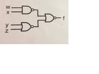

Find the simplified equation (SOP FORM) corresponding to the following circuit (i.e. apply Demorgan's theorem to bring the negations inside the parenthesis).
View attachment 1466So is it saying W NAND X which means (w!x!) + YNORZ so (w!x!) + (y!z!) = wxyz?
Technology news on Phys.org
Your notation is a bit confusing to me. So let me write it as I'm used to.
You have f = (w NAND x) NOR (y NOR z).
Written in boolean form this is:
$$f = \overline{\overline{wx} + \overline{y+z}}$$
Applying De Morgan's Theorem ($\overline{p+q} = \overline p \cdot \overline q$) yields:
$$f = \overline{\overline{wx}} \cdot \overline{\overline{y+z}} = wx(y+z)$$
Perhaps you can simplify it further to SoP form?
