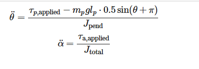

I need to simulate a rotary inverted pendulum in Python for a school project. After about a week of struggling with this, I need help.
# Compute accelerations using the equations of motion
alphaddot = tau_m / J_p # Motor arm angular acceleration
thetaddot = ((m_p * g * l / 2) * np.sin(theta[k-1]) + tau_p) / J_p #pendulum acceleration
[Mentor Note: Two threads on the same project have been merged into one]

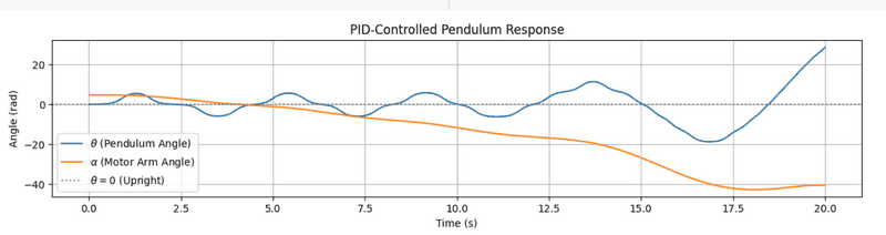

I need serious help with this. I'm totally stuck as to why my results are mediocre. It would mean a ton if someone could at least point me in the right direction.
Below is my attempt:
You import scipy.integrate.solve_ivp but you are not using it and have hand-rolled Euler integration instead. Why?
Have you tried altering the parameters of e.g. the moment of inertia of the rod (dramatically, like a factor of 2)? How does this affect the result?
I tried both methods and both produced the same results. I used Euler integration for simplicity and because I know how it works.
Yes I played with the parameters for hours. I feel like my physics model/underlying equations may not be accurate. The thing that I'm most confused about is that the motor arm does not oscillate with the pendulum. Instead I get results like:
I would expect the motor arm angle to change as it tries to balance the pendulum. Instead I get a flat curve with no high frequency component.

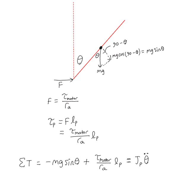

Have you drawn a diagram showing all the forces/torques?
Have you made a physical model of similar dimensions? How well does a motor of similar size work with a pendulum that heavy?

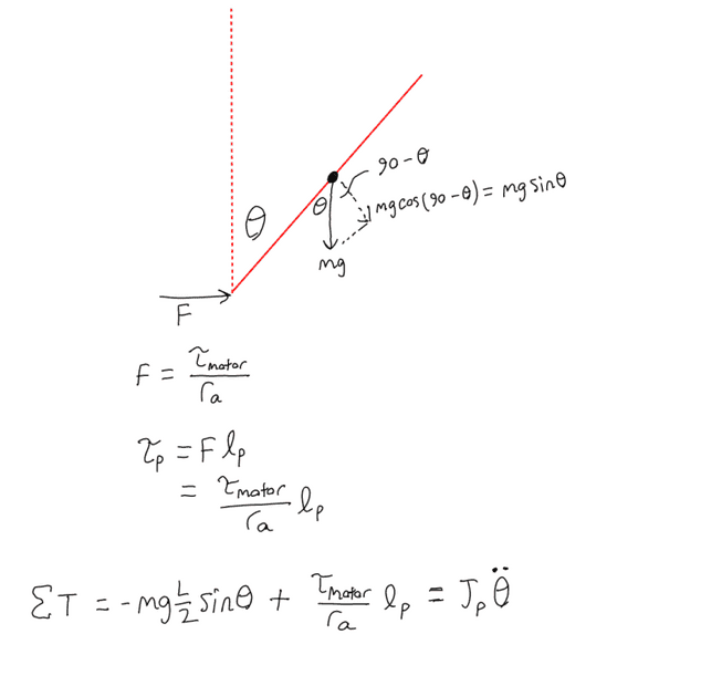

Do you think my calculation for the inertia seen by the motor shaft is correct? Isn't this just J_p or should this be J_p + m_p*r_a**2?
For what its worth, if I try run (using python-fiddle.com) the code pbuk has been so nice to put in code tag, I get the plot below which does not look like your plot (but perhaps you or pbuk has tinkered with the parameters since your plot was made). A quick test running with half dt seems to yield same plot so its likely this particular solution (if it is correct) is not outside the stability region for the Euler method as applied to your field.

I need help calculating inertias for a rotary inverted pendulum system (Furuta pendulum). This is for a school project.
The pendulum is a unform rod, and the motor arm is a unform rod.
The equations of motion are:
Where theta is the angle of the pendulum (0 degrees is in vertical position). alpha is the angle of the motor arm.
The question is, what do I use for J in these equations?
chatGPT gives me the following for the inertias, which I doubt are correct. I'm totally stuck on how to derive these myself.
I feel J_eff should be dependent on the angular velocity of the pendulum, since I can see torque being applied to the arm if the pendulum is rotating very quickly.
