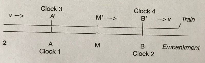

I have another diagram for what may possibly be a distantly related thought. The image below was distorted in making a photo, but the idea should be clear.
It seems to me there are at least two ways of measuring simultaneity for a person on the platform and a person on the train. Start with the train observer: He could wait for the light to hit him at M' and make a judgment which would lead to him saying that A and B are not simultaneous (Einstein's point, I think). And the person on the bank at M can also judge in at least two ways. He can wait for the the light from A and B to hit him and then judge, in which case A and B will seem simultaneous.
Now whatever criteria Einstein used that he thought could establish for an observer on the train and one on the embankment that M and M' are at the same place at the same time, the same criteria could be used to establish that A and A' and B and B' are at the same place at the same time. So A', M', and B' align with A and M and B at the same time.
Now we might imagine 4 clocks all set at 0 and made to trigger when they are hit by a light coming from A and B and to mark that moment. So a second way for an observer at M to tell if A and B were simultaneous would be to walk over to A and B, after the fact and see if they were triggered at the same time. And the same for an observer on the train at M'. He could decide not to trust his eyes but to go and examine the two clocks and use them to establish simultaneity.
In this case it seems to me, both observers will pronounce that A and B were simultaneous, even if they will think the start and finish times of A and B are different.
Now you are going to have to deal with the length contraction issue I mentioned earlier.
Here's the original train experiment as it occurs according to the embankment.
Flashes are emitted from the red dots as the ends of the train reaches them and the trian observer is next to the embankment observer. Train observer runs into right flash before left flash catches up to him. One thing to keep in mind is that since the train is in motion with respect to the embankment, the train is length contracted according to the embankment and this length contraction is what allows the train to fit exactly between the red dots.
However, according to anyone at rest with respect to the train, the train is not length contracted, but instead, it is the embankment that it in motion and length contracted. Thus the train cannot fit between the red dots, the front of the train hit the right red dot before the back of the train reaches the left red dot. Since both the train and embankment have to agree that the flashes are emitted when the ends of the trains pass the red dots, the flashes cannot be emitted at the same time according to the train, like this:
Note that according to the train, the flashes still meet a the the embankment observer. Also note that the midpoint of the train is next to the same point of the tracks when each the light flashes reaches him in both animations.
A and A' being next to each other is simultaneous with B and B' being next to each other in the embankment frame, but this is not true for the Train frame. when A and A' are next to each other B and B' are apart,and B and B' are together A nd A' are apart.

west-river said:
Now whatever criteria Einstein used that he thought could establish for an observer on the train and one on the embankment that M and M' are at the same place at the same time, the same criteria could be used to establish that A and A' and B and B' are at the same place at the same time. So A', M', and B' align with A and M and B at the same time. (emphasis mine)
This is wrong. "at the same time" is dependent on the reference frame. Observer M will say that the clocks at A' and B' have been set out of synchronization. And M' will say the same thing about A and B. They can not agree on what "the same time" means.
Suppose M and M' both synchronize their respective clocks at the ends by flashing a light and saying that time 0 is when the light reaches the ends. Then M would say that M' has synchronized the A' and B' clocks wrong with clock B' time 0 being too late compared to clock A' time 0 (clock B' ran away from the light source and clock A' ran toward it). Similarly, M' would say that M has synchronized the A and B clocks wrong with clock A time 0 being too late compared to clock B time 0 (clock A ran away from the light source and clock B ran toward it). This is the root cause of the problem with agreeing on simultaneity.
You might object that there are better ways for M and M' to synchronize their respective clocks at the ends of the train. But the experiments measuring the speed of light contradict that. No one was ever able to detect any different speed of light no matter what the velocity of motion was. That means that any physical method of synchronizing clocks kept coming up with the same synchronization that they would have had if they had used light. It shows that synchronizing clocks using light travel time is deeply compatible all physical processes.
And you might say, as your diagram implies, that "at the same time" means when all the points are side-by-side. But don't forget that observer M sees that the length of the train has gotten shorter. So they no longer line up as you show it. Some points are side-by-side at different times from other points -- another example of "simultaneous" not being well-defined.
You can see how closely intertwined all this is. The mathematics and logic of SR all works together and is consistent. When thinking about it, one can not ignore any of its effects on simultaneity, time, or length.

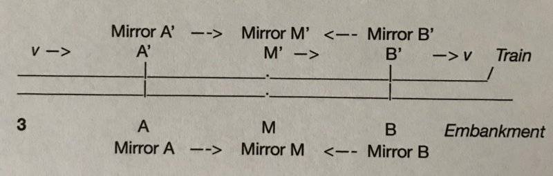

In addition, I ask your patience to look at one more of my diagrams. I read every one of your posts written in this chain. I did not understand much of what you wrote, but I think I did understand a good chunk of it. (I had not reached the sections on contraction of time and space in Einstein's original text I have been studying, as I have been trying to go slowly and absorb only what I can). (It doesn't make sense to me that I have to read a few sections ahead in order to understand what I have been reading in these earlier sections.)
I sincerely do not want to ask you to respond to something that is, to you, clearly wrong. I don't like persistent elementary questions in my own field especially if they feel obstinate. I will not feel bad in any way if you feel you have written enough posts and have no wish to beat a dead horse, as it were. With this said, I think the following diagram expresses my thoughts more clearly and would like to know if there is a feeling I am understanding more or not.
I have dropped all references to clocks. Mirrors A', B', A, and B are set at 90 degree angles, so light hitting them is reflected to Mirror M and Mirror M'. I may still be missing something critical that you have all said more than once, but it seems to me that, according to Einstein's original text, it is possible that two strokes of lightening, one at A and one at B are simultaneous for an observer at M (that is, "with reference to the railway embankment") (we can imagine him with explosives attached that will go off when two beams of light hit Mirror M at the same time, and, in the way I have set it up, he does explode). This is true whether or not there is a train.
But now assume there is the train that is moving to the right in the picture. When lightning hits A and B (simultaneously, with reference to the embankment, it also moves towards the train. Clearly, if the train is moving, then A beam will arrive at M' after B beam arrives there, and M''s explosives will not be set off as the beams aren't arriving to him simultaneously.
But the two beams also will hit the two mirrors, Mirror A' and Mirror B'. It gets a little foggy for me here, but it seems to me that the reflected lights off these two mirrors will arrive at Mirror M' at the same time and set off the explosive at M'. So the light going directly from A and B to M' will not set off the explosive, but the light viewed indirectly, via Mirrors A' and B', will set it off. So the observers at M and M' will both suffer from an explosion, though (again this is foggy to me) neither would experience the other's explosion (if they were able to) as simultaneous with his own.

From the point of view of M, M' is moving towards B' and away from A'.
Even if, according to M, the lights somehow hit mirrors A' and B' simultaneously, they can't hit M' simultaneously.
IMHO, this is a mistake. So much of this depends on how an observer would set synchronized clocks in his inertial reference and how an observer in another frame would say that those clocks are set wrong.
Yes
I disagree. M will see M' moving and the lights will not hit M' at the same time. M' will think that the lights did not hit A' and B' simultaneously, so he does not expect them to reach him at the same time. So both M and M' agree that M' will not explode.
That was wrong.
But there is a separate set of beams from A and B that hit the mirrors, Mirror A' and Mirror B'. It is my understanding of such a situation that they would reflect their lights towards Mirror M' and would meet at the same time and set off the explosion.
That was wrong.I don't understand what you are saying here.
What I meant here is that there would be an explosion at M and one at M' (given the mirror reflection scenario), but neither M nor M' (if they were not damaged by the explosions) would think the other explosion happened at the same time.
