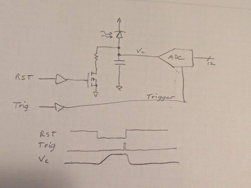

What I still haven't been able to figure out, and maybe its deserving of a new Doofus post is, what does the "simplest" circuit for this look like? I am not an EET, haven't even played one on TV, but what I don't understand is how I could close a switch for example and dump charge stored up from something like a photodiode to something like an ADC. IE if I leave the switch closed for 2s I see 1V across a resistor when the switch is opened, then if I close it for 4s I see roughly 2v.
Maybe even remove the amplifier, lets assume a solar cell like PD like a BPW34 or something and a bright light source, heck why not a proper pocket photon cannon operating at 5mW radiant output.

Here's how I did something like this in a pulsed laser to measure the pulse energy. Yes, the sketch is simple but not much simpler than the actual circuit, not counting the digital timing stuff. The only analog amp was built into the ADC front end. Key point though, we knew when the laser would fire.
Sorry, I may be off base, I haven't read every post yet.
Not off base at all. Most of the post is me failing to ask for examples like this because I lack the vocabulary and clarity of thought.
Super cool! I take it your ADC had a transistor that only read off the measurement when trigger went high? I like this because it shows that you only need a transfer gate transistor if you need an off-state while the circuit is live. For my goofy interests I can probably remove that transistor as well and end up at a 2 transistor model.
1 to reset and 1 to amplify/read out.
DaveE's circuit uses the diode in photo-conductive mode rather than photo-voltaic mode.
They are called sampling ADCs and are VERY common. Many ADCs that don't appear to be sampling to the user will still do so internally since they can't deal with an analog voltage that changes during the conversion process.

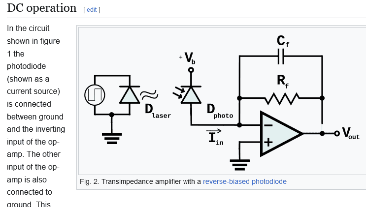

Since you are wanting to learn about these types of circuits, here are a few topics and links for your reading:
For a single photodiode, you often use a simple (photo)current-to-voltage circuit:
https://en.wikipedia.org/wiki/Transimpedance_amplifier

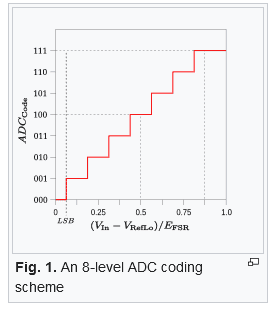

And after the S/H circuit, you would use some form of ADC circuit to digitize the voltage for further processing by a microcontroller (uC) or other processor:
https://en.wikipedia.org/wiki/Analog-to-digital_converter
