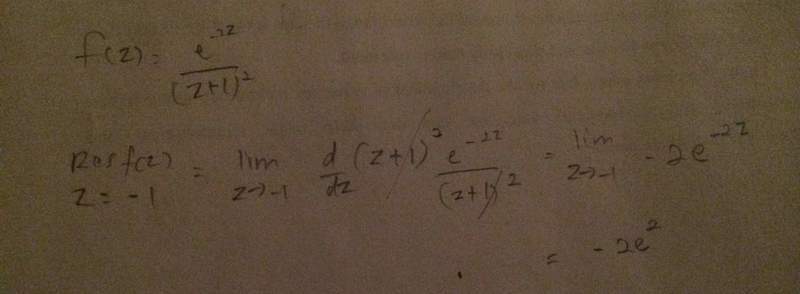

Can someone check if I got the answer right?
Find the singularity and the residue.
##f(z)=\frac{e^{-2z}}{(z+1)^2}##
My solution:
$$Resf(z)_{|z=-1|}=\lim_{{z}\to{-1}}\frac{d}{dz}((z+1)^2\frac{e^{-2z}}{(z+1)^2})$$
$$\lim_{{z}\to{-1}}-2e^{-2z}=-2e^{2}$$
A check with Mathematica tells me that your solution is correct :-).
