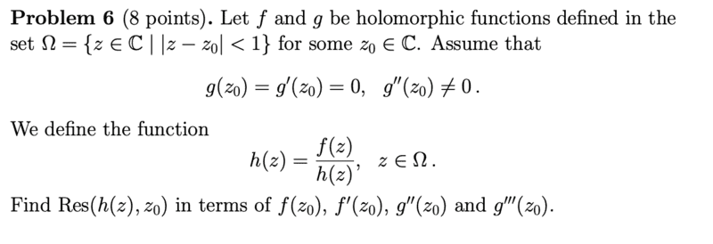

Find ##Res(h,z_0)##
##h=\frac{f}{g}##
Text of Problem 6 (8 points): Let f and g be holomorphic on the disc Omega = {z in C : |z - z0| < 1}. Assume g(z0) = g'(z0) = 0 and g''(z0) is not 0. Define h(z) = f(z)/h(z), z in Omega. Find Res(h(z), z0) in terms of f(z0), f'(z0), g''(z0) and g'''(z0).
There is a typo. It should say ##h=\frac{f}{g}##.
Attempt: ##f## and ##g## are holomorphic on ##\Omega##. Homomorphic functions form a ##\mathcal{C}^*## algebra, so ##h## is holomorphic on ##\Omega## where ##g\neq 0##.
If ##z_0## is a removal singularity of ##h##, then ##Res(h,z_0)=0## by Morera's theorem.
Assume ##f(z_0)\neq 0##, then ##z_0## is a second order pole of h since ##g''(x_0)\neq 0 ##.
$$Res(h,z_0)=lim_{z\rightarrow z_0}\frac{d}{dz}\Big[\frac{f}{g}(z-z_0)^2\Big]$$
This method produces indeterminate forms, even after applying the L'Hopital's rule.
Let ##\mathcal{C}=\{z:|z-z_0|=1/2\}##. By Residue theorem,
$$Res(h,z_0)=\frac{1}{2\pi i}\int_\mathcal{C}\frac{f}{g}dz$$
This integral cannot be computed since ##f## and ##g## are not given.
Can anyone think of a clever method that could solve this problem?
You can just start writing out series. The Taylor series for f is known. For ##1/g##,, you know if looks like ##1/((z-z_0)^2(a+b(z-z_0)+c(z-z_0)^2+...) ## with a nonzero.
You can basically just bash this with the Taylor series of ##1/(1-x)##. Let ##x=\frac{1}{a}(-b(z-z_0)-c(z-z_0)^2+...)## and write
$$\frac{1}{g}= \frac{1}{(z-z_0)^2 a (1-x)}$$
Now apply the normal Taylor expansion to ##1/(1-x)##, and after the first couple terms you should get stuff that is high order in ##(z-z_0)## and hence can be ignored.
