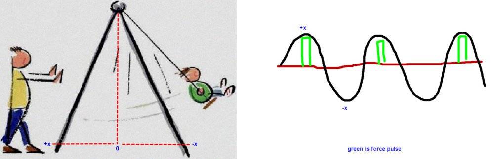

I'm just curious to know that how a sinusoidal 'push' could be used for a swing. I was trying to solve another problem but I believe knowing this could help me to solve the other problem.
Hi,
Please have a look on the attachment. The displacement of swing from the equilibrium position, x=0, is considered to be maximum, +x, when the swing reaches the person who is pushing it. The pushing force is of short duration and could be approximated by a pulse. I hope I have it correct.
How can sinusoidal force be applied instead of pulses? I think it would require some kind of a motorized mechanism but I can't imagine it would work or implemented. Could you please help me with it?

In an exaggeration, imagine that your pulse hits the sinusoidal curve only at ##\pi/4## and ##3\pi/4##.
It seems that a pulse would act more as two successive impacts (and perhaps as a resistive brake in between) than a modulating push.

Yes, the timing is important. You need to sync your pushes with the swing frequency otherwise your pushes would act like brakes.
In the picture from my first post, the push is applied at 90 degrees of the swing's motion.

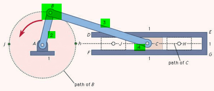

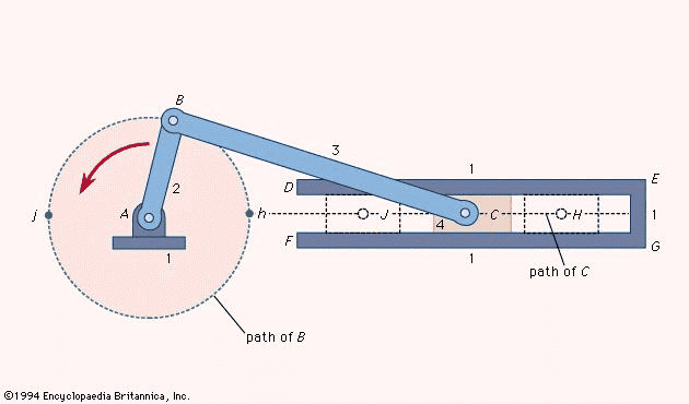

Also similar to things like crank mechanisms for train wheels. This example is not harmonic motion (i.e. try writing the position of the slider/piston as a function of the angle of the radial arm, which goes as ##\theta = \omega t##), though approaches SHM if the length of the long arm gets really big compared to the radial arm.

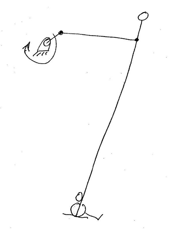

Here's an idea. A crankshaft with connecting rod connected to the swing high up near the pivot. The connecting rod pushes on the swing rope and exerts a force on the swing when the rope deflects. If the drive frequency approaches the swing natural frequency, the force will approach zero. If the drive frequency is near the swing natural frequency, the result will be a beat frequency, where the swing amplitude, at the swing natural frequency, will continuously change from near zero to a maximum and back to near zero. If the drive frequency is very low, much less than the swing natural frequency, the kid will barely move. If the drive frequency is very high, much higher than the swing natural frequency, the kid will perceive that (s)he is sitting on a vibrator. The crank radius and the attach point will determine the maximum swing amplitude.
The connection needs to be up near the pivot. If the connecting rod was attached to the swing seat, and the frequency set too high, the kid would get flung out.
This is not a true force input. A true force input would drive a simple spring mass system amplitude toward infinity at the natural frequency. But then, a swing is not a simple spring mass system and the natural frequency changes at large amplitudes.

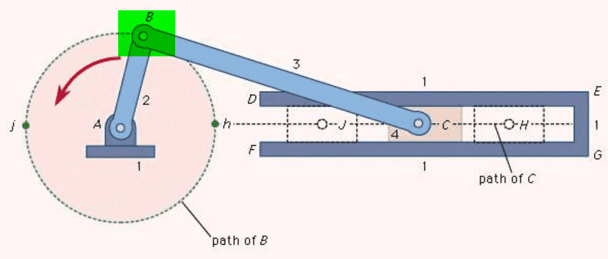

Thank you. I think if the connection at "B" between arms "2" and "3" was permanent then the motion of slider/piston, labelled "4", would become SHM. Please correct me if I'm wrong.
Source: https://www.britannica.com/technology/slider-crank-mechanism
Thank you.
Possibly, one can use stiff rods in place of a rope.
"If the drive frequency is very low, much less than the swing natural frequency, the kid will barely move. " - If rods are used instead of rope then the swing seat would move very, very slowly.
"The crank radius and the attach point will determine the maximum swing amplitude." - Attach point "B" would play an important role where "A" is pivot point. Think of torque=(force)*(distance_from_pivot_point).
If the crank radius is too small then attach point "B" would move around a short distance from its equilibrium position.
"A true force input would drive a simple spring mass system amplitude toward infinity at the natural frequency." - Yes, a theoretical mass spring system where spring could be extended to infinity and compressed to negative infinity around its equilibrium position.
But there is a problem. The force won't be purely sinusoidal. Wouldn't it more of 'reciprocating' force?
