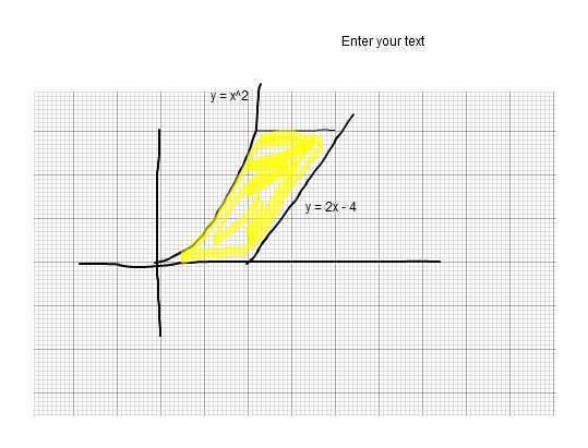

HermitOfThebes
25
Sketch the region defined by: y ≤ x^2 and 4 ≥ y ≥ 0 and y ≥ 2x − 4. Evaluate the area defined by the above inequalities.
I have already plotted the positive part and found the area. However, the negative part seems to be infinite. I am required to find the area, surely it's not infinite then.
The area under x^2 in the negative part, above 0, below 4 and above the line is an infinite rectangle starting from x=-2 and stretching to negative infinity. What am I doing wrong?

There is no "negative" part. The region of interest here is bounded on the left by ##y = x^2##, on the right by y = 2x - 4, above by the line y = 4, and below by the line y = 0. The entire region lies within the first quadrant.

I agree with the OP: the region sought lies below the parabola y = x^2, above the line y = 0, below the line y = 4 and above the line y = 2x - 4. The part of the region in {x < 0} is, indeed, unbounded: except for a parabolic northeast corner, it is a strip extending left to ##x \to -\infty##. Perhaps there were some restrictions on ##x## that the OP omitted.

I suspect that whoever set the question either didn't realize that the unbounded part exists, or assumed that anyone reading the question would interpret it as referring only to the bounded part. In either case the question is poorly designed. It happens.
You cannot possibly be penalized if you both give (with working) the correct area for the bounded part and point out the existence of the unbounded part.
I don't see how. Here is the region as I see it.
The author of the question could have been clearer in the description.

The OP did not include the restriction x >= 0; in fact, he used a package to produce a plot having both {x>0} and {x<0} regions. There are (x,y) points with x < 0 that satisfy all the listed inequalities, such as (x,y) = (-3,1). It is a feasible point because 1 < (-3)^2, 1 > 0, 1 < 4 and 1 > - 4 + 2(-3).
I agree about clarity, though.
The question did not include any limits to the range of x. In fact, I copied the question as it exactly is from the Oxford Physics Aptitude Test. Weird that they would do such a mistake.
