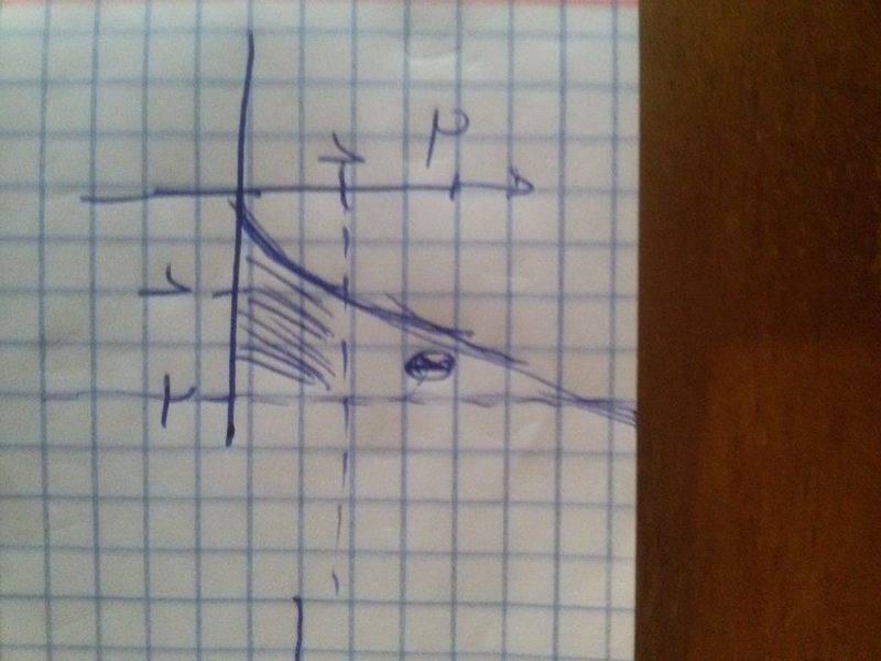

∫∫D x2+y2dA
where D is the region limited by: y=x2, x=2, y=1 (dA = dxdy)
So basically i sketched the area, and i get the area under y=x2 0<x<1 and a square at 1<x<2 , 0<y<1
So i divded the integrals; for the square ∫0112 of x2+y2dxdy
for the y=x2 part is the part i need help/confirming x goes from 0 to 1(so integral os x2 with those bounds), and i used substitution for y=x2 and got dy=2xdx so integrated from 0 to 1 x42x dx
So i was thinking about this in another way, which gave me the same answer.
So i integrated x2 and kept the bounds so i got [(x3)/3]10 then integrated y2 and set its bounds to 0 to x2 and substituted so i got [(x3)/3]10 + x^5/3, and moved that inside the bounds.
Am i correct?

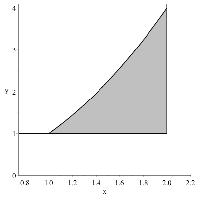

I have a different interpretation of the region D.
You can always plot these in utilities like Wolfram Alpha.
I take the upper boundary of D to be y = x2.
The right hand boundary is going to be the vertical line x = 2.
The lower boundary will be the horizontal line y = 1. This will also produce the left-hand limit of the region in terms of the x-coordinate, where y = 1 intersects y = x2.
The region D is roughly in the shape of a triangle, with the hypotenuse being a segment of the parabola y = x2 and the base being the line y = 1.
https://www4f.wolframalpha.com/Calculate/MSP/MSP641hbce22d448geh87000055267hbac324i9hi?MSPStoreType=image/gif&s=47
As far as the mechanics of your integration goes, I have no idea what you are trying to do. You don't have the correct region for D and your substitution is frankly a head-scratcher.
In any event, since you have the double integral of a sum, it would probably be easier to split this into the sum of the integrals of x2 and y2 dA and add the results:
##\int \int_D (x^2+y^2)\, dA = \int \int_D x^2\,dA + \int\int_D y^2\, dA##
The best way to perform this double integral is to do the dy integral first. The dx integral (done second) has two parts that will have different boundaries. So basically divide the double integral into two sections: 1) ## 0<x<1 ## and 2) ## 1<x<2 ##. The dx integral from 0 to 1 is bounded by ## y=x^2 ## for the portion 0<x<1 (as you correctly noticed), and by y=1 for ## 1<x<2 ##. For the first section , you need to carefully look at the dy limits. Do you see that the upper limit here (on the dy integration) needs to be ## x^2 ##? It does take a little effort to get some proficiency with these double integrals... editing...sorry, my mistake=I see I got the boundary region incorrect. I mistakenly thought you had y=0 as a lower boundary...but I see, yes, I didn't read your problem statement and assumed you had the region correct...

Who says you can't integrate w.r.t. y first? dA = dxdy is the same as dA = dydx. In fact, you should get the same answer to the integral regardless of which variable you choose first.

Not completely correct. Your upper dx limit needs to be 2. And your y limits are incorrect.

Please read SteamKing post #2 and also my edited post #3. Your boundary is a triangular shaped region. (See his graph). Also see my edited post #9.
ohhh so i thought the lower limit was y=1 as shown in the pic. you are telling me its only the area marked (1) ?
Yes...The other calculation would make for an interesting exercise also, but it's not what the problem asked for... The lower limit is y=1, not y=0. With the new area, try to write out the limits. You're on the right track=you simply selected the wrong region...
