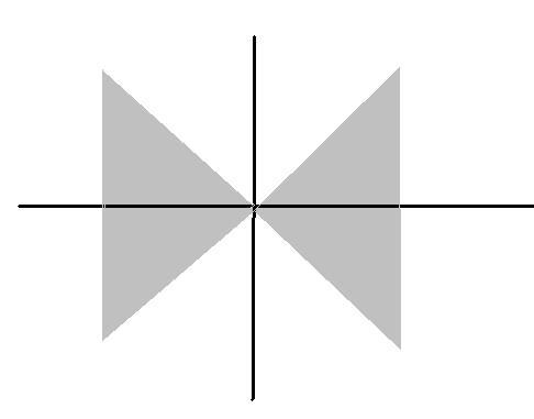

a) |Arg z |< pi/4
well ok that means
[tex]|\theta_{0} + 2 \pi k| < \pi/4[/tex]
so the theta must alwasy be less than pi/4
im not sure how to sketch this... i mthinking its the attached diagram, but only the triangle in the first quadrant
yes it is a domain
umm is there a way to do with without diagram??

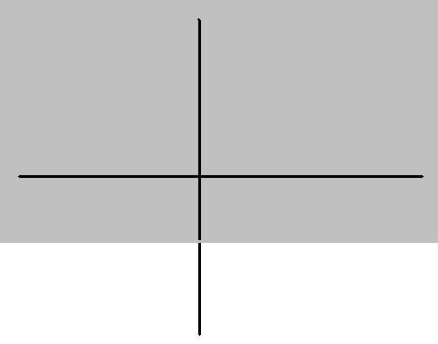

b) -1 < I am z <= 1
shaded part of 2
yes it is a domain
the region bounded by y = -1 from the bottom and unbounded above

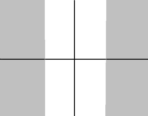

c) (Re z)^2 > 1
like 3?
not a domain
unbounded

Is this the principal argument: Arg as opposed to arg? If so then where is the branch cut for Arg? And what does that absolute value sign do?
it is Arg
what do u mean branch cut??
stunner5000pt said:
it is Arg
How is Arg z (the principal argument of z ) defined?
the branct cut is at pi/2 for the principle argument yes??
No... And if it were the question posed to you would be somewhat impossible.
[tex]|Arg z|< \frac{\pi}{4}[/tex]
It really doesn't matter whether or not "Arg" means the principal argument: since it's between [itex]-\frac{/pi}{4}[/itex] and [itex]\frac{\pi}{4}[/itex], it IS, except for the negative values, the principal argument!
Stunner5000pt, it's not just in the first quadrant- since this is absolute value, you can have negative values of the argument and so include the fourth quadrant.
"b) -1 < I am z <= 1
shaded part of 2
yes it is a domain
the region bounded by y = -1 from the bottom and unbounded above"
Why unbounded above? It say "Im z<= 1".
"c) (Re z)^2 > 1"
In other words, Re z> 1 or Re z< -1.
