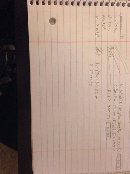

A skier of mass 70 kg is pulled up a slope by a motor-drive cable.
a. How much work is required to pull him 60 m up a 30° slope (assumed frictionless) at a constant speed of 2 m/s?
b. What power must a motor have to perform this task?
Help would be greatly appreciated!
I will be attaching pictures in a reply to this in a minute, and these pictures will have my work. I have no idea if I did it correctly, as my textbook does not have an answer for this proble, but I don't feel totally clueless, so that's good?
The thing is, there's no acceleration, so it's kind of confusing, because the normal W= Fd doesn't seem to work because I keep getting 0 N, because a=0, but when I solve using ΔU, I actually get something, but once again, I have no clue if it is correct. Any help is greatly appreciated!
My attempt!
As you rightly observe, the constant speed means no work is done on the skier. All the work is done against gravity, and PE is the way to figure that out.
But you seem to have some mistakes in your calculations. Where does the 35 come from?
What force does your F represent? I assume it is the tension in the cable. Over what distance does that force haul the skier?
Likes komarxian
35 comes from my sine calculation for the height of the slope. I will reloik at the problem about the tension, thanks!
Then I suggest you work it out again.
Likes komarxian
Okay got it.
Okay here is my work! The problem I solved for was #48 and my answer is 700 Watts?
Yes. Quickest way is to note that 2m/s up a 30 degree slope is 1m/s vertically, so power = mass x g x 1m/s.
Likes komarxian
