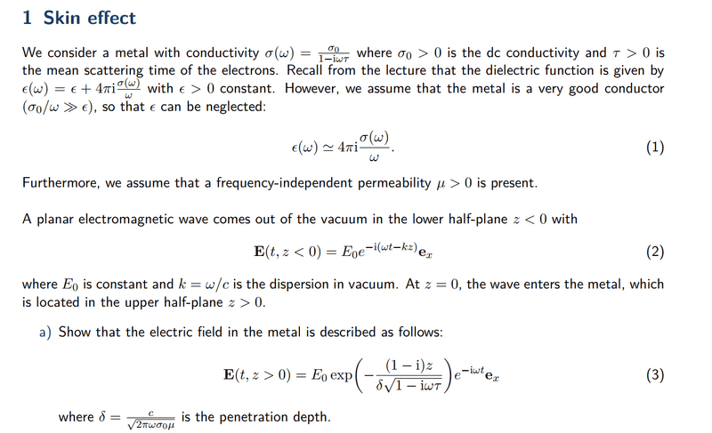

Hi,
unfortunately, I can't get any further with the following task, or rather I don't know how to start:
Printed lecture-notes page titled Skin effect, deriving the electric field of a planar wave entering a metal with conductivity sigma(omega) = sigma0/(1 - i omega tau), including equations (1) to (3) and penetration depth delta = c/sqrt(2 pi omega sigma0 mu).
I'm also a bit confused, the task says that you have to calculate the electric field in the metal. Since it is a metal, i.e. a conductor, there is no electric field in the conductor, is it rather the electromagnetic wave that penetrates the metal that is meant to be calculated? Because ##\delta##, i.e. the penetration depth, appears in the formula.
Would I then have to calculate the wave vector ##k## when the wave penetrates the metal? Unfortunately, I don't know where to start to solve the problem.
I have now proceeded as follows, ##E##, ##B## and ##k## are all perpendicular to each other and it is a complex electromagnetic wave, then you can represent Faraday's law of induction and the Ampère-Maxwell law with the wave vector $k$ as follows in the CGS unit system:

Lambda96 said:
I'm also a bit confused, the task says that you have to calculate the electric field in the metal. Since it is a metal, i.e. a conductor, there is no electric field in the conductor...
Based on your second post, you've realized that a metal is an imperfect conductor and hence the electric field can indeed be non-zero inside.

We had defined Maxwell's laws in the lecture as follows
$$\begin{align*}
ik \times E&= i \omega B\\
ik \times B&= \mu_0 \sigma(\omega)E - i \mu_0 \epsilon(\omega) \omega E
\end{align*}$$
Then we have the following relationship for the conversion from SI to CGS ##\mu_0=\frac{4 \pi}{c^2}##
That's not right. The vacuum-permeability ##\mu_0## is related to the speed-of-light ##c## and the vacuum-permittivity ##\varepsilon_0## according to:$$\mu_0=\frac{1}{c^2\,\varepsilon_0}$$

Lambda96 said:
The expression E can now be ignored and the equation can be rearranged
What does this mean? ( Please justify this step more explicitly )
$$\begin{align*}
-k^2 E&=(-i \frac{4 \pi}{c^2} \omega \sigma(\omega)-\frac{4 \pi}{c^2} \epsilon(\omega) \omega^2)E\\
0&=k^2 E+(-i \frac{4 \pi}{c^2} \omega \sigma(\omega)-\frac{4 \pi}{c^2} \epsilon(\omega) \omega^2)E\\
0&=E(k^2-i \frac{4 \pi}{c^2} \omega \sigma(\omega)-\frac{4 \pi}{c^2} \epsilon(\omega) \omega^2)
\end{align*}$$
For the expression to be zero, either ##E## must be zero or the expression in the parenthesis must be zero, which is why I get the following equation, which I can solve for ##k## and I meant that I can ignore ##E##.
$$0=k^2-i \frac{4 \pi}{c^2} \omega \sigma(\omega)-\frac{4 \pi}{c^2} \epsilon(\omega) \omega^2$$
To get this equation you have already made the ansatz that E is a plane wave with possibly complex wavenumber, I believe, but you sounded a little bit unsure. This solution is important to know well.
