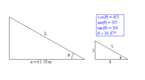

Bit of a problem with your working there. Consider,... is the hypotenuse of a triangle ever shorter than either of the other sides? Here L is the hypotenuse of a triangle with one side of length 61.22 m. Draw your triangle with the 'x' side and 'L' hypotenuse in place and redo the calculation.

Yup. Be sure to indicate where the known angle is.
Alternatively, you could use geometry and similar triangles since you know that this triangle is similar to the 3-4-5 triangle from your initial diagram.

That'll do it. But it's kind of taking the long way around :smile:
You can write ##cos(\theta) = x/L## so that ##L = x/cos(\theta)##, and cos(θ) can be obtained from the similar 3-4-5 triangle as cos(θ) = 4/5.
Or, avoiding trig functions altogether, you can use the "raw geometry" of similar triangles:
##\frac{L}{x} = \frac{5}{4}## so that ##L = x \frac{5}{4}##
where x is 61.18 m, of course.
