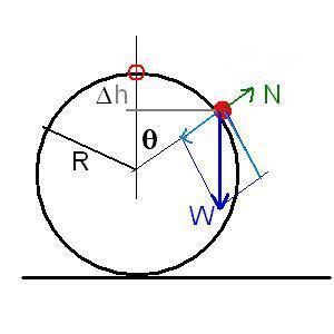

My uncle gave me this problem:
A very small ball of mass m is at the very top of a big ball of radius r and is pushed very lightly (initial velocity is basically zero). What is the angle θ that the small ball's position vector (originating from the origin of the big ball) makes with the vertical y-axis as the small ball comes off of (or departs from) the big ball? PLEASE TELL ME ONLY IF I'M ON THE RIGHT TRACK OR NOT! IF I'M NOT, A HINT WOULD BE GREATLY APPRECIATED (sorry for the all-caps, but I just need a little push in the right direction, not the fully worked out solution).
ƩF=ma
The normal force N exerted on the small ball by the big ball is N=mgcosθ.
ma(y)=mg-Ncosθ
a(y)=g-gcosθcosθ
ma(x)=Nsinθ
a(x)=mgcosθsinθ
a(x) and a(y) being the accelerations of the ball in the x and y coordinates, respectively.
Once I got the accelerations, I was sort of stuck. I'm not really sure what to do next. One thing I've though of is to think of under what conditions the small ball has departed. What I came up with was that when
x>rsinθ,
the small ball has departed. (x being the x position of the small ball). I tried integrating the acceleration in the x direction twice to get position, but that didn't really help.
Does anybody have any hints?
Thanks very much.

The case is different from moving along a straight line on a flat slope: the ball does not have acceleration component normal to the slope. Moving on the big sphere along its circular path, the small ball has both tangential and normal components of acceleration. The difference between the normal component of gravity and the normal force is equal to the centripetal force: macp. The normal force is not equal to mgcos(θ).
ehild

The problem is, I don't know how to find hf! (For simplicity, I denote h0 to be 2r.)
hf-ho=Δh. See picture.
ehild
ehild
Yes, I'd thought of that, but didn't think it was relevant... Why is it important?
You need hf-hi to find the speed at a given theta. hf-hi=-Δh can be expressed in terms of the radius of the circle and theta.
ehild
