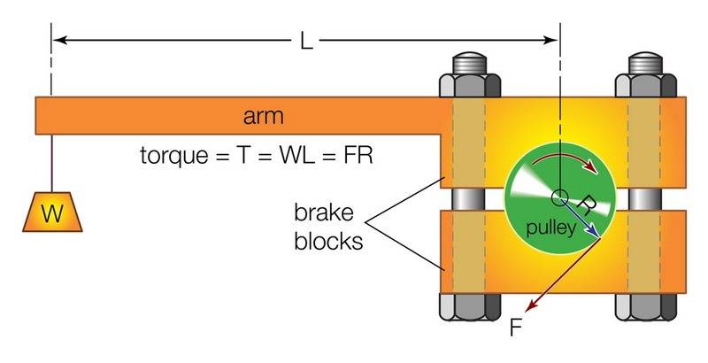

What I'm having trouble seeing is how the torque arm is attached so that it will capture that braking load. In theory what I would need to do, is to apply friction the shaft via the brake pads, to some arbitrary RPM I would like to measure the torque and power at. Once I have the RPM and the load cell readout, calculating torque and power is simple.
Here is the standard prony brake setup:
What they are doing here is trying to balance the moment arm by adding weight as friction is applied to the shaft. Essentially the same principal as having the moment arm contact a load cell, only the moment arm would be 180 degrees apart and trying to rotate down onto the load sensor. I do like this setup, but I figured it was more practical for shafts that aren't rotating in the several thousands of RPMs. So I wanted to look into the brake caliper idea as seen in the first image. As you can see here though, as you tighten the nuts down, you are essentially creating a clamping force on the shaft thereby slowing the shaft down.
I hope I've made my question clear and have not confused anyone, if I still need to clarify, feel free to post and ask some more questions.
Main Question: I don't understand how they have the moment arm attached in the first picture so that the braking force that the caliper applies to the brake disk is transferred to the arm which then presses down onto the load cell at a given RPM. It looks to be able to pivot on the shaft. If anyone else has any alternatives to this idea, feel free to post them.
Brake dynamometers rely on a shaft rotating in fixed bearings with a brake rotor also mounted on the shaft, with a reaction arm, (centred on the shaft by a bearing), that prevents rotation of the brake stator. It is the scaled force from the long reaction arm that you measure.

VitaX said:
Because essentially, doesn't the brake and torque arm need to be connected in some shape or form to transfer to the braking force from the brake pads to the load cell via the torque arm? The torque arm can't be situated on the shaft so that its a tight fit because then it would stall the engine. So as the torque arm is contacting the load cell, the drive shaft needs to be able to spin while under load.
Baluncore said:
...with a brake rotor also mounted on the shaft, with a reaction arm, (centred on the shaft by a bearing), that prevents rotation of the brake stator.
A bearing on the common shaft carries the reaction to the force on the load cell. If you are unhappy with a reaction arm on a pair of bearings at 7k RPM then how come you are not unhappy with the shaft mounting bearings?
A drum brake can be balanced about the shaft axis. A disk brake needs two calipers to avoid high side force on the shaft.
An alternative is to align the motor shaft with the reaction arm shaft. The brake then straddles the gap.

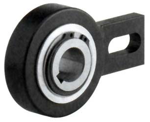

Sorry for the double post, but I think I understand what you are saying now with the torque arm mounted on the bearing itself.
http://www.smaltd.com/FreeWheels.htm
You are referring to this right? Where the bearing housing is essentially the load absorber and the reaction arm would rest solely on a load cell to absorb the load and give an accurate readout of the braking force applied to the engine shaft. Is this what you had in mind?
Yes.
The rotor of the brake always spins with the engine.
The stator of the brake remains attached to the reaction arm.
The reaction arm is pivoted on independent bearing(s), on the engine shaft, or aligned with it's axis.

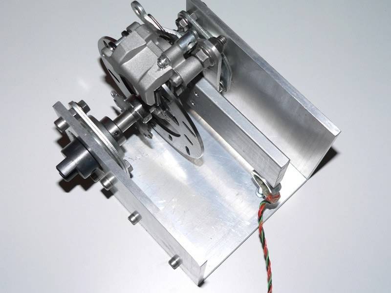

So essentially what I would have is the following:
An engine with a centrifugal clutch mounted on the flywheel
Machine a shaft of 3/8" diameter to mount inside the clutch housing
Along this shaft, I would have a set of ball bearings to support the shaft
The brake rotor would be mounted in between theses ball bearings on the shaft
This is where I'm trying to formulate how to actually measure the applied braking force on the shaft:
Pivoted on one of the ball bearings, is the torque arm that is also connected to the brake caliper (somehow)
As you apply braking force to the rotor, the brake pads and caliper should essentially try to rotate on that disk
Stopping that rotation is the torque arm which is pressing down on a load cell to give an accurate read out of the braking force applied at the corresponding RPM
Do you think that is how the reaction arm is setup in this image?

Yes, the main shaft there seems to run all the way through with a bearing between the reaction arm and the main shaft.
My guess is that a 3/8” shaft will be a bit weak for the expected maximum torque. Take a look at a similar capacity engine and see what diameter shaft it uses. My guess would be 5/8” or 3/4”.
In effect there is an input shaft and an output shaft with the reaction arm.
The friction brake partially couples those two shafts.
With sufficient support the one shaft can be cut so the bearings at the stator end do not have to spin.
The reaction arm can then be mounted in a low speed bushing but is still axial with the input shaft.
A disk brake will provide side forces on the reaction arm bearings. A drum brake will be better balanced and so not require as much alignment control.
